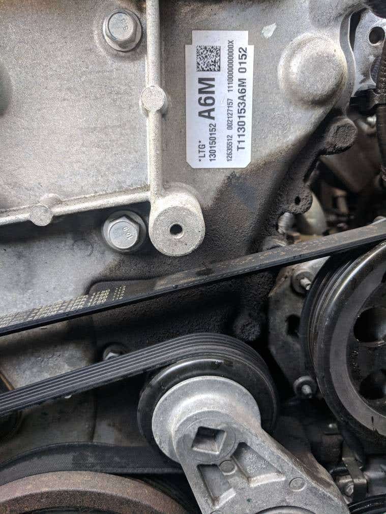

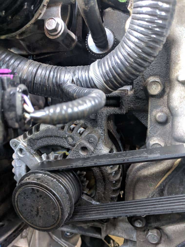

Was cleaning my car the other day and noticed that I had sludge build up on turbo side of timing chain/belt cover and on the alternator. Now I'm not too worried about it, I'm sure it's just a bad gasket, but with 45,000 miles I'm a little surprised. Anyone else had this issue this early on?

I went thru this BS... They call it "seepage" and seepage is not covered under warranty. I got the service mgr, shop mgr and my SA out to the drive and asked them to take goo whiff of my engine bay and the call and tell my wife why the garage smells like burnt oil. I also offered to park my car in anyone of their garages over night. no takers. He is the repair invoice and you will see why they don't want to fix it.

Hey guys, wanted to bump this thread. I just took my ATS in for a coolant leak at 60k miles. There was a hairline fracture in an aluminum piece. While the car was in the shop the Service Advisor mentioned there was oil seepage around the timing cover. He said it wasn't worried about it now and that I should keep an eye on it. Seems crazy at just 60k miles. They quoted are $1,500 for a timing cover reseal. Has anyone else gotten this fixed out of warranty? If so, what did it run ya?

#12 ·
