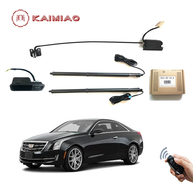

The only ones I see on that seller that are for a car with a trunk (and not an SUV gate) are the CT6 and the Passat. The CT6 pic shows two strut actuators, while the Passat shows a motor driven single actuator (like the actual factory install on the CT6). I've sent them a message with a pic of the ELR trunk and hinges and will report back.
#11 · (Edited)
Looking at the supplier's store, most of the units use the same control box. Seems simple, power harness, actuator harness, optional foot kick harness, and the can bus harness. Push the factory remote (or the button on the trunk, or the button on the door), and the factory latch releases. That signal is intercepted by the control box and tells the actuators to fire. Hopeully, the wiring for the CT6 is the same as the ELR. I'll figure out the diagrams and post screen shots.
For those that like reading instructions, here is the complete install for the Tesla. Should be pretty much the same for us (different wiring connection locations, colours, of course).

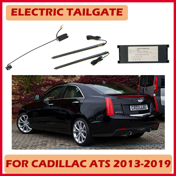

While ordering hood struts yesterday so I can convert the ELR from the cheap prop (I'll keep you posted, and start a new thread), I thought of this project again.
They make kits for the ATS sedan now. I'm thinking it's time to order. I'm willing to bet that if it works on the 2014 ATS it will work on the ELR. I'll head over to the ATS section and see if anyone has installed one.
