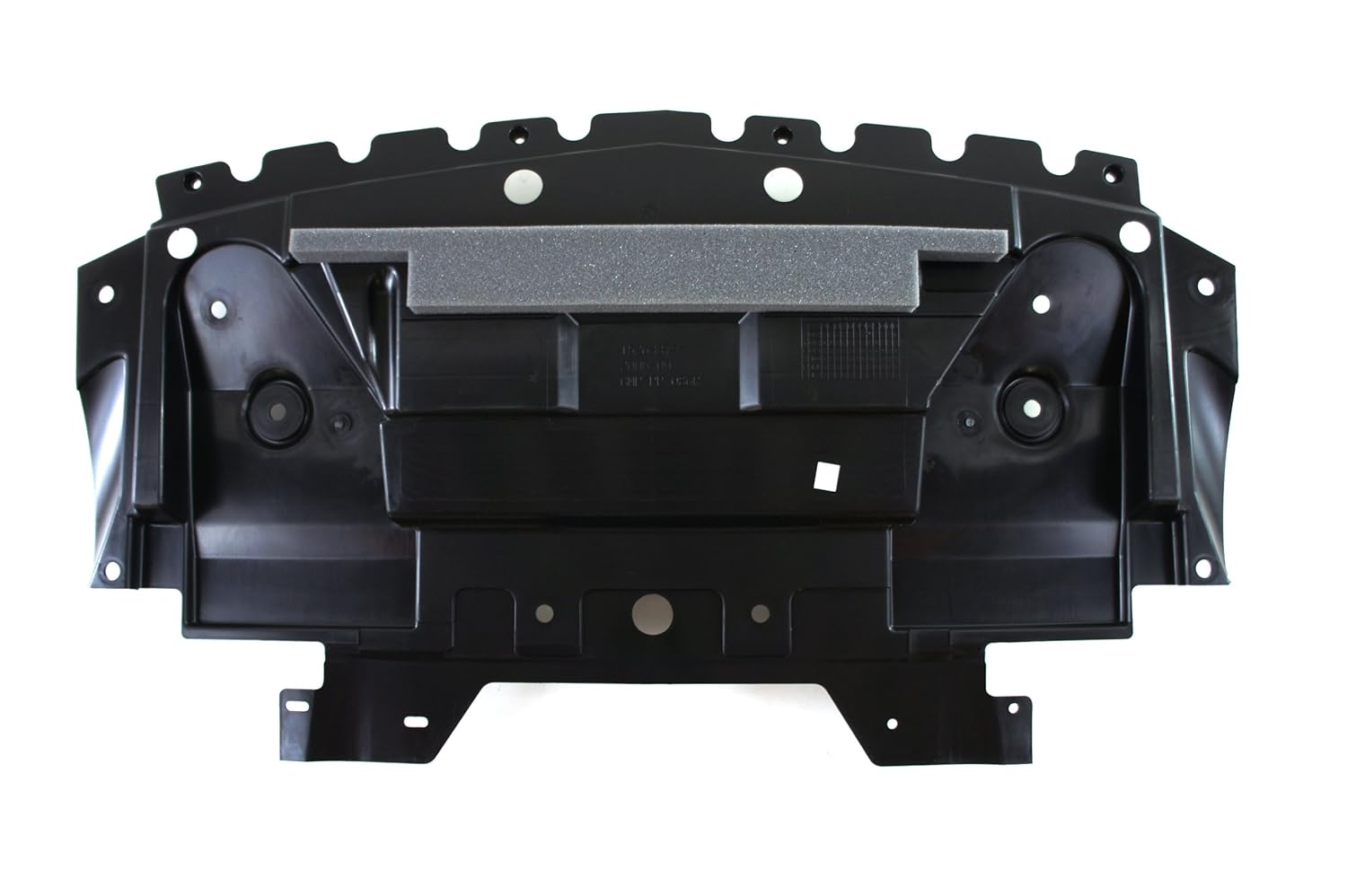

Question - so that I'm clear on this subject - the "front splash shield" is basically under the radiator and the "rear splash shield" is under the engine - does this have to be removed when the oil gets changed (my car does not have this one currently)? Is there a splash shield that goes under the transmission?
#20 ·
The one pictured above covers the transmission and the back end of the engine, the front shield covers the front end and the radiatorhttps://uploads.tapatalk
Thank you - so can the oil be changed without removing the "back splash shield" because if it does have to be removed the oil man will most likely lay it aside when he completes the oil change - yes? Also I notice 2 different styles of "back" splash shield - I assume RWD and AWD being the difference - yes?
#23 ·
Yes two different splash shields for awd and RWD. And advise whoever is doing that oil change to make sure they put the shields back properly, one missing clip and the wind will do the rest. I've gone through 3 in total before giving up and removing them all together (talking about the front shields)
When I bought my car both the front and rear splash shields were missing and part of the front left inner fender was damaged - so I replaced both the inner fender and the front splash shield not knowing there was supposed to be a rear splash shield too - but I discovered the important of having a front splash shield while installing it is that it supports both left & right inner fenders and the front lower bumper - the shield ties all 3 together. You all might want to note this in each of your situations - IMHO I think the lack of the rear splash shield is a minor concern.
