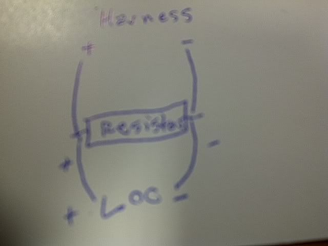

I was gonna tell tell you to splice a 8ohm 5w resistor to make it work properly. Place it between the sub input (amp output) wires and the LOC.
#25 ·
Yup. One on stock sub voice coil 1 postive, one on stock sub voice coil 1 negative, and repeat for voice coil 2. At least, that is how it was explained to me. Just wire them in in between stock sub wires and LOC inputs. By the way, I finally got around to replying to your PM. Sorry it took so long. Good luck.

So to clarify, I would essentially need 4x of them (one for each wire, 2x sets of amp outputs into the LOC), both on the negative and positive sides?
You only need 2. One for each voice coil
just wire one connection of the resistor on positive and the other side on the negative. Same location.
#27 ·
---------- just wire one connection of the resistor on positive and the other side on the negative. Same location.
Okay, I guess I'm confused again. What you're saying is from the amplifier, take each set of (+) / (-) and connect them together with a resistor? How do you connect it to the LOC then?
The below photo is a .PNG that I made explaining what I thought I needed to do and what it sounds like you're suggesting. Any insight would be great!
http://s1334.photobucket.com/user/jasonatjl/media/cts2_zps66a5ee0f.png.html
#28 ·
Jasonlee said:
Okay, I guess I'm confused again. What you're saying is from the amplifier, take each set of (+) / (-) and connect them together with a resistor? How do you connect it to the LOC then? The below photo is a .PNG that I made explaining what I thought I needed to do and what it sounds like you're suggesting. Any insight would be great! http://s1334.photobucket.com/user/jasonatjl/media/cts2_zps66a5ee0f.png.html
http://i6.photobucket.com/albums/y205/Offthahorseceo/utf-8BSU1HLTIwMTEwMjA4LTAwMTE3LmpwZw.jpg
It is explained and confirmed to work in this thread and I got the pic from there: http://www.cadillacforums.com/forum...c-audio-video-security-systems/221579-02-deville-wiring-subwoofer-amp-need.html

Cadillac speakers only turn on when they see a load on them. I was running a loc for awhile and had to add resistors so the factory amp would turn on. I've gone with complete aftermarket now. Spliced into door speaker wires at the amp in the trunk. Disabled the factory amp. Put a kenwood kvt 617 in place of the ashtray and installed a 3g ipad on the dash. Ipad fits perfect.
