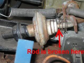

In the mean time, I've taken pictures of a mechanism below that is broken and needs replacing. It looks like some sort of vacuume mechanism and seems to be choke related.
Basically, the "rod" inside the spring, protruding from the vaccume cylinder is broken right at the point where it enters the cylinder. When the accelerator is applied, the lever pressing against that rod moves back from it and the rod will intermittently fall out of place. Without that rod in place, the vehicle experiences hard starting.
My assumption is that temperature affects how far that rod protrudes which affects the position of the accelerator?
What seems odd to me is that this unit is completely independant of anything else (no hoses or connections), nor does it seem to have adjustment functions.
Anyway, the unit needs to be replaced.
Can someone please identify this part for me?
Also, will the spring come with the new part or is that a separate replacement?
Thanx.

Dashpot, a throttle damper, keeps the throttle from suddenly returning to idle when you release the gas pedal to prevent stalling of the engine. So, you don't have to replace it if your car doesn't stall when suddenly releasing the throttle pedal, since it's broken, then just remove it. And it's not supposed to work as an idle stop, there is an idle speed screw for that. About hard starts, on carbureted engines it's recommended to depress the gas pedal slightly before starting.

The part´s name is Throttle Dash pot. When the engine is cold, it pushes the throttle adapter plate (connected to the accelerator lever) until warming up to increase engine speed and as manual says it prevents engine stalling in the way Fleetwood70 has told. Here you are the removal, installation and adjustment instructions from the 69 shop manual (69 and 68 carbs. are the same):

It´s difficult finding a new throttle dash pot. Only found one at Caddy Daddy for a 64 (But I think it´s the same): http://www.caddydaddy.com/FUEL-amp-...Carburetor/Dashpot/-1964-Cadillac-Carburetor-Dash-Pot-Check-Assembly-p4783.html
Another option is asking a carb. shop if they could fix your broken part.

Thank you all for your assistance... I've been out of town so I apologize for the late response.
The '64 version is not the same as the threaded rod is much shorter.
The appropriate part # is 1483692 from GM.
Other equivalent after market part numbers are D5-112R and 40-431 (Hope that helps others looking).
I was able to find (rare find) one on ebay for $14.40 shipped.
