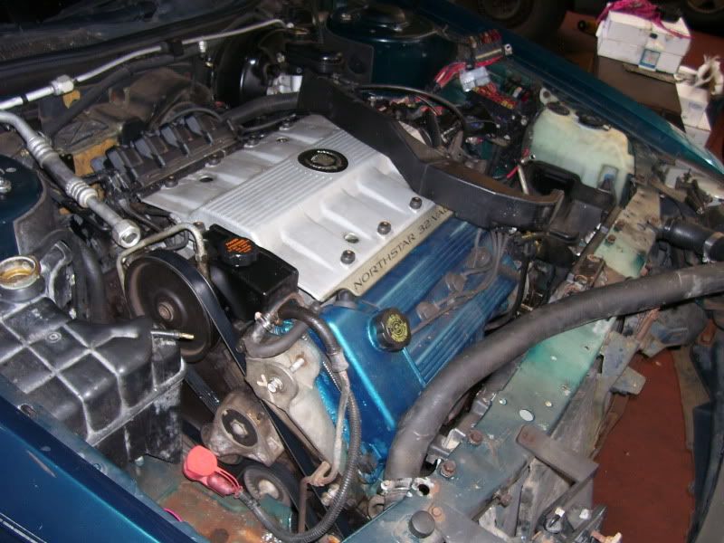

Here's some pics:
I was amazed at how cleanly it it was cut. I was expecting some folded metal and carnage. But no, it had a nice clean disk cut out of it... :hmm:

Nice pics Krashed - thank you for that - we appreciate it
Sorry bout your troubles. Thanks for the pics!
Great pics, that is so weird

Wow. Thanks for the pictures. Glad it didn't cause any other damage. Seem like an easy fix for you. Took you less than 3 hours?(going by the time stamp)

Edit: here's some pics
This is one of the better looking waterpump housing gaskets. The others disintegrated.
The waterpump housing with the new gaskets on it.
I find it amazing that after doing a job like this all I had to do was turn the key to the "on" position a few times to prime the fuel system and then it fired right up and settled down to an idle at 700 rpms. It just makes you smile when you see it happen.
