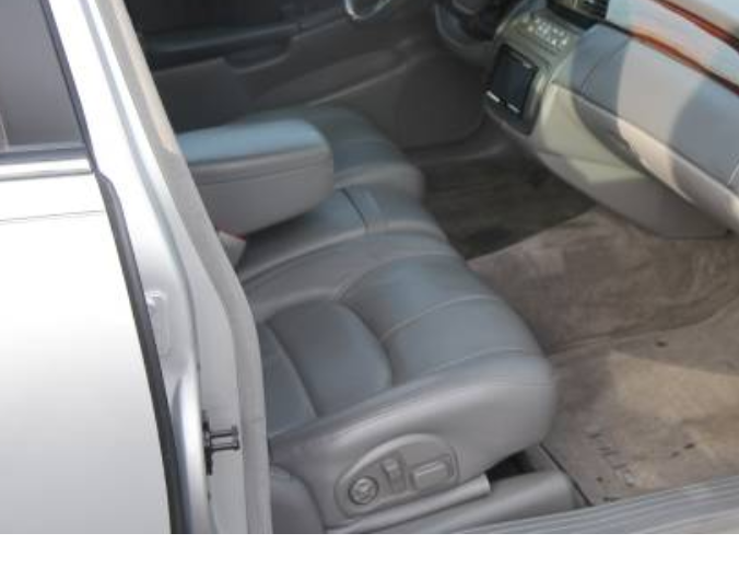

Is the little round button to the left of the reclining controls is the lumbar/massaging seat handle?
Thanks,
[URL=http://s293.photobucket.com/user/msag45/media/DHS%20seat%20controls.png.html][/URL]
My '03 has adjustable massaging lumbar in all 4 corners.
yes - and if you look really close -
you will see the word AUTO at the top -
this activates the "massage feature" -
that inflates and deflates the airbags -
you might like to look through the Owners Manual -
to see what is available -
go here for a free download -
http://justgivemethedamnmanual.com/cadillac/2004-cadillac-deville-owners-manual/
