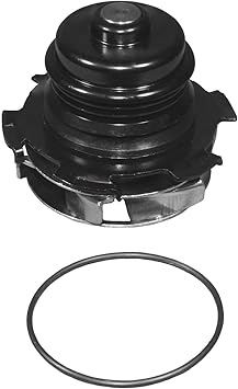

regarding the water pump -
there are TWO different ACDelco pumps available -
the ACDelco "gold professional" replacement part - ACDELCO 252-707 - $43 - with free shipping -
and the actual OEM part - ACDELCO 251-660 - $54 - with free shipping -
personally - I'd spend the extra $11 and get the OEM part -

The water pump main O-ring is supposed to be lubed with raw coolant before locking in the pump counterclockwise to 73 lb/ft. Align the small lock tab correctly before rotating the assembly.
#14 ·
Whaever hose comes off the hanger at the parts store..........
Some "tips" say to strecth the o-ring before putting it on, it will go on eaier and them mold into shape, do you do that?
Also autozone has the wrench socket for teh water pump and it says for caddy, the oroily auto store says they have one but it just says for GM cars does not mention caddy, will teh oriolly one work?
