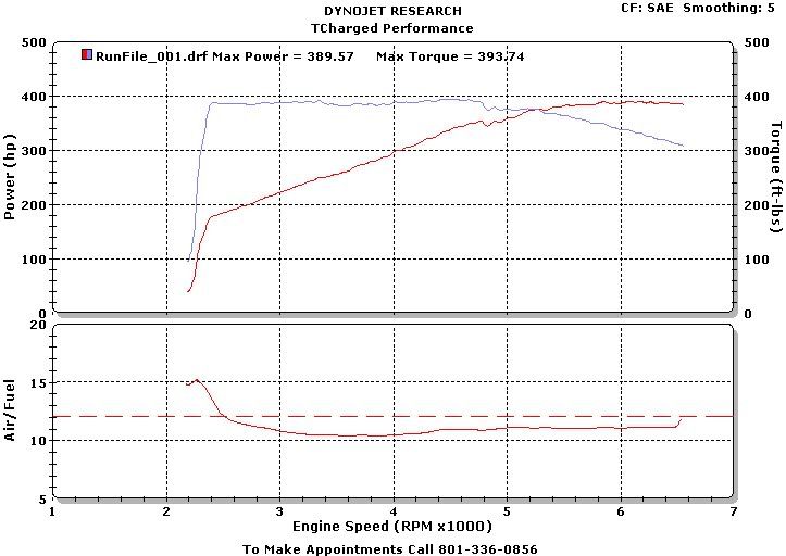

Here are the pictures and write up I promised.. Here is how it worked out.. I want to share my findings with you all.. When I own a dyno it makes it really nice to figure out mods truly works and which ones do not. So this is a lot of time and work but I will try to keep it simple for you guys. Please note.. I am running 5.5 lbs of boost.
When I bought the car it had kooks long tubes and high flow cats with the maggie on it, rest of the car was stock. I threw it on my dyno and it made 389 WHP. I was not happy at all.
I then figured it was because it was using stock mufflers on a car that didn't come with a supercharger so I took off the stock mufflers and welded on some magnaflow stainless steel ones. Put it back on the dyno.. 413 WHP.. okay, getting a little better but still not happy.. I am tuning NA LS6 motors weekly that make 400-430.. So I knew I had something more left in it.
I then put it back on my dyno and tuned it all with HP tuners. This brought me up to 425 whp.
From there I was stumped.. I couldn't figure out why my power was so pathetic. I had a new K&N filter.. Tune, nice flowing exhaust, etc.. The power would not move above 425 and I knew something wasn't right.
Then I started thinking about what makes power or restricts power and of course air flow came into my mind once again. I started messing around with my intake system and decided to work on it a little. I completely took out my stock air box and left it open..
Then I went to auto zone and bought a 20 dollar sceptre air filter and connected it right to my intake tube. Threw it back on the dyno and my blower was twice as loud through the whole dyno run.. I was watching my HP tuner log during the run and I seen it pulling timing like crazy through the run where it never did that before, but I just let it finish the run. I couldn't believe what I seen on my dyno results..
Long story short I retuned my car and took out timing and added more fuel to where the computer wasn't pulling any at all and that is how I ended up with the power I did at only 5.5 lbs of boost. the difference was the intake. It may or may not work for you guys but it was the golden ticket for me.. I need to mention that you MUST re tune your car if you do this. I couldn't believe how much my tune changed by only changing my intake..
This is what I started with when I bought the car
this is where it was after I changed my mufflers and tuned it..
this is where I am now.. the ONLY change between the last dyno sheet and this one is my air intake and a retune. Notice how much better my torque line looks and how it doesn't fall off.. This is because it was able to pull in a lot more air than it ever was before. The higher you rev the maggie the more air it needs and a stock box can not keep up. No matter what filter you use.

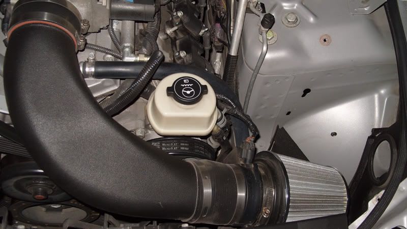

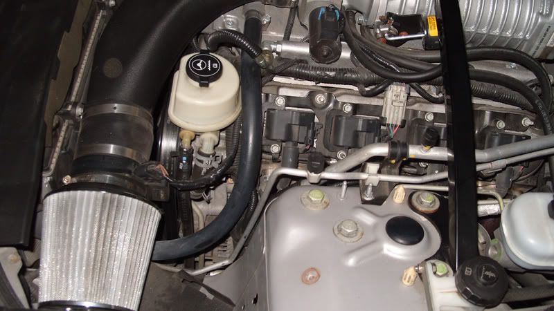

This is what it looks like:
Thanks guys .. hope this helps a few of you! I am sure you can cut your inner fender and make some type of a true cold air system but I didn't want to hack up my car.. So I left it the way it is and just put the cone filter where the stock air box was. Seems to work just fine for me right where it is..

did you pull the rubber snorkel??? removing it might open the filter up to the elements but it will definitely create a direct path for cool air to flow to the intake..
one of these might also help you get colder air for that beast..
you could probably fab up a shield like this out of sheet metal for alot cheaper then the lingenfelter shield costs

yeah I just barely put this on my car. I definitely need to make some type of a heat shield to put on the back side of the filter.. Obviously having that engine heat sucking into the filter will hurt my power a little. I literally took out my air box, hooked up the new filter, retuned my car and left everything else the same. I want to play with this a little more but so far my results were incredible with what I did.. The power pulls so much longer and harder it's nuts.. I still want to work on it a little more and change things around a little and work on a shield and better air inlet system.. Im guessing there is about 10 more potential hp left in the intake system.. I would of never imagined I would gain 50 from what I did though.. But I guess it makes sense.. Your only as good as your weakest link.. You can't suck a marble through a straw.. The stock air box is a massive air restriction.. Blower wants more air than the stock box can give it.

50 hp gain but you lost 5 torque?

We see this a lot on many different setups.. having pressure and less air flow will increase torque from the get go but it will fall off much faster and harder when it can't breathe or move any more air. with the last dyno run notice how much harder the HP line goes up and how flat the torque line is all the way across the power band.. That is because it is sucking in as much air as it wants all the way through and it doesn't fall off. Having a restriction of some type will always gain a little torque but lose HP.. If your restriction disappears you will gain HP and lose torque.. It's all about pressure and of course your displacement has a lot to do with torque..
