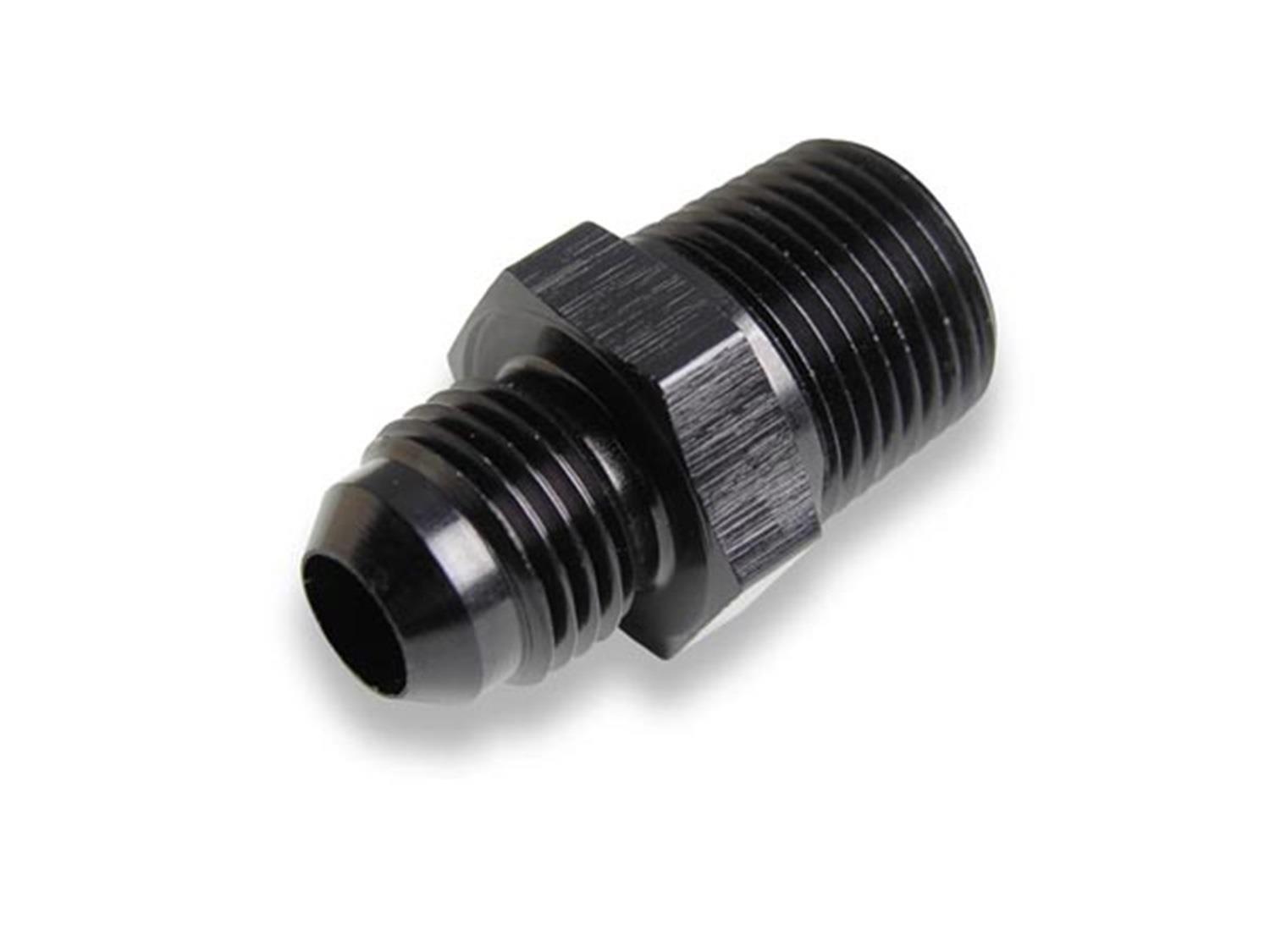

You can cut the metal line and then use AN fittings from the stock line to cooler. I would also suggest getting AN fittings for the cooler also.
You just need to find out the thread size on the cooler. You can either go with -6 or -8 hose if using braided stainless steel or using rubber hose like this:
