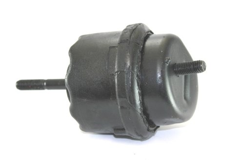

My next oncoming project is front engine mount. Got mount, got tools.. working on getting good weather..
As manual I'm going to use this thread http://www.cadillacforums.com/forums/cadillac-tech-tips/239484-seville-front-motor-mount-replacement-how.html even it is not about Deville, I'm pretty sure that kind of the stuff looks absolutely the same. This is the best step by step thread with pictures I found. Now I can understand what is going on.
I will appreciate all tips because I didn't start yet and want to make it same day w/o problems. Also my question, will I need 25" breaker bar or 18" will be fine? I know, cradle bolts high torqued.
