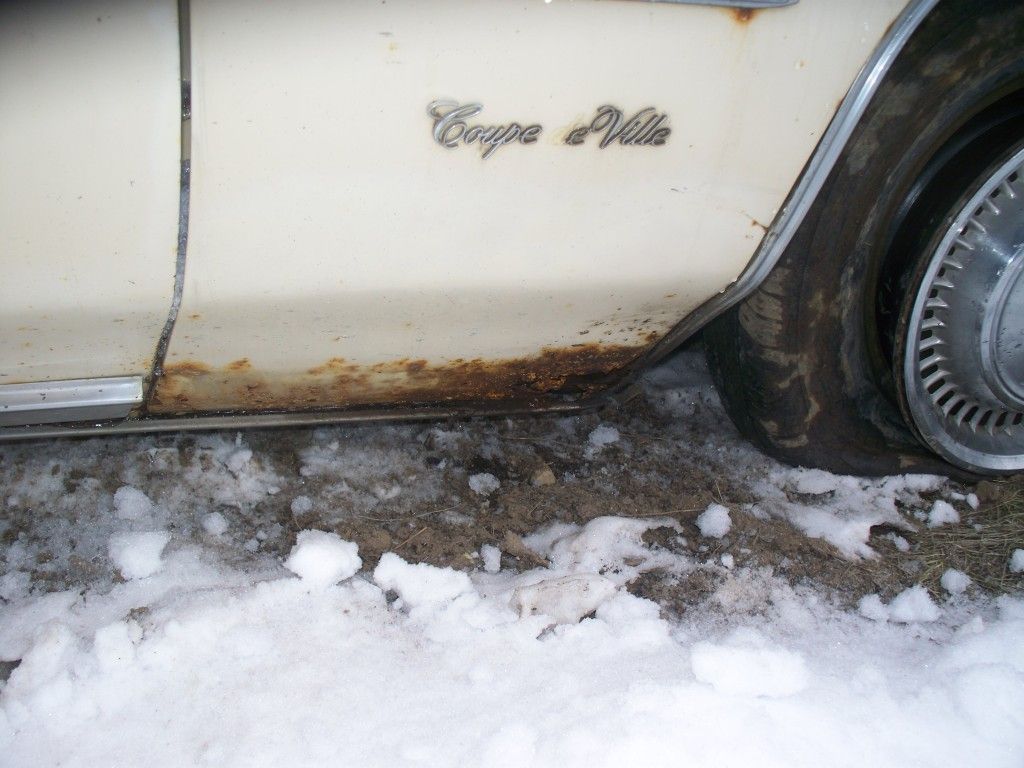

Would I buy the car? Depending on the shape of the frame and floorpans, yes. Would I daily drive it? Probably not, because I'd go broke paying for gas. It obviously needs some attention, especially the rust on the quarter and fender. Trunk pan looks decent enough though. Alternator probably needs replacement. 800 is an ok price. I'd see about haggling it down some though (because you could probably get it for 100-150 cheaper).

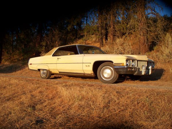

As to the car itself, it looks pretty decent for the money. I see two completely different sets of photos, first on a road with tires holding air like it was put in park and photographed. The next set not on a road, flat tire, and snow on the ground. So, the question is, which of those two cars is $800? If it is the first one, cut the mattress open, run over there with the money and snap it up. :getaway:
If, as I suspect, it is the second then it is more complicated.
Why is it sitting? How long has it sat? Was it prepared at all for the inactivity? Those would be the first questions. Being pulled into a field and parked for a long time is not good on a car of this age. Getting them on the road again can bring up a lot of little problem to attend to.

As for it the money pit aspect; unless you can live with leaving it in that condition, a car like that will nickle and dime you to death. It wouldn't be too expensive to get it in driver condition (not entirely reliable, but not a junk heap), but once you do, all of things that are wrong with it are going to get worse. Overall, to get the car as a reliable daily driver, you will probably throw more money at it than it will ever be worth; you'll need to fix all of the leaks, get new tires, and probably service the suspension before it would ever be dependable.

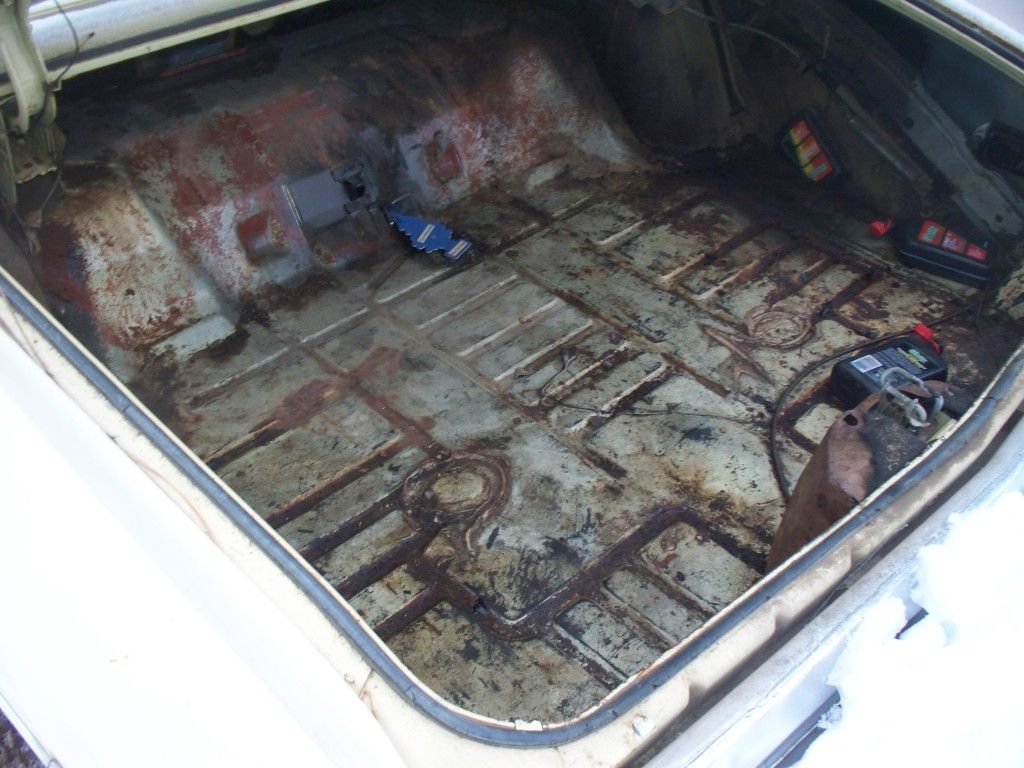

The trunk pic clearly displays the difference that 1971 & 1972 GM full-size cars have compared to '73-'76: a totally flat trunk floor underneath where the spare tire tire is normally stowed. '73-'76 has a hump. This reflects a gas tank with a large hump on top containing the sending unit, as opposed to a flat-top tank, with a flush sending unit.
A person can't buy a new '71-'72 full-size GM gas tank, unless they find one NOS. They can buy a new aftermarket '73-up style gas tank. I learned about this difference the hard way...

Speaking of sitting the pictures are the same car! The first ones got me in the door the second set made me re-evaluate how this is going to work. the first set of pictures were takin in September and the next set were takin two days ago. The guy has been starting it regularly, but hasnt been driving it do to the radiator leak. Thats how the tire gave up.
