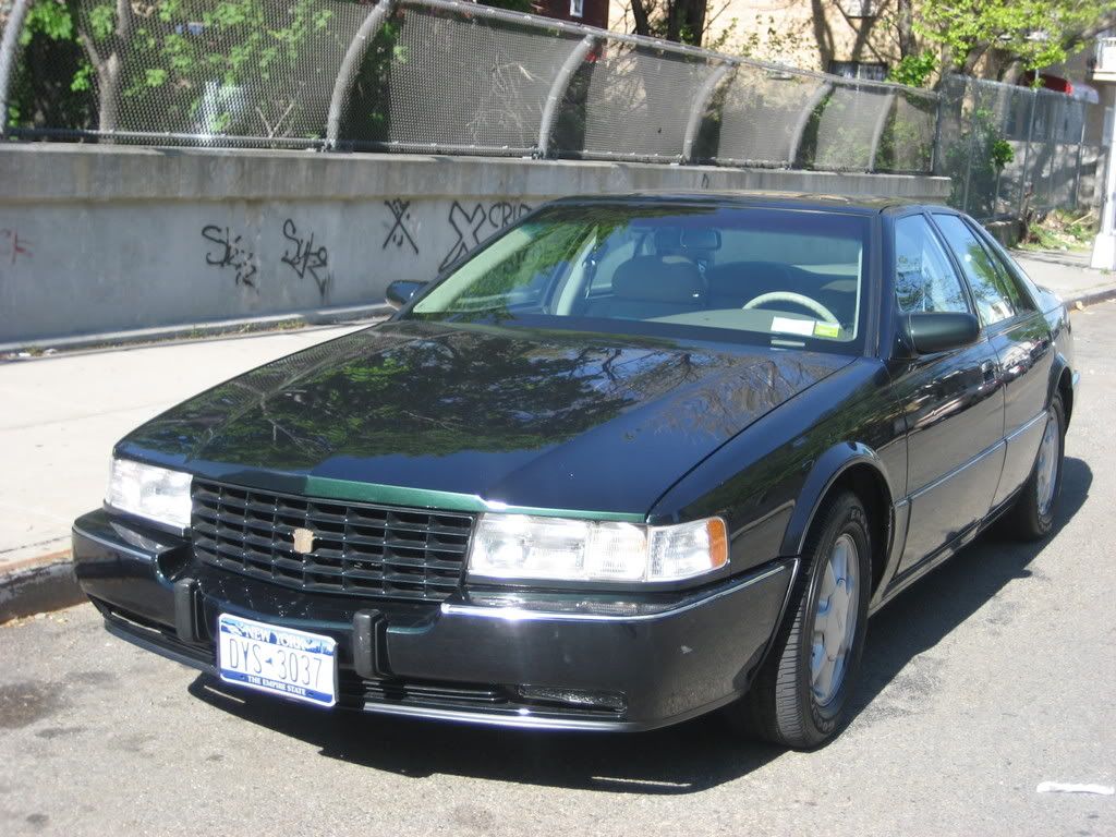

Ok. I have a choice to make and I'd like some feedback/guidance regarding my options.
1. I have not done a block test. I asked a few times what this would do but nobody answered me. Should I get this done? What will it do... tell me if I have a gasket problem or a crack in the block?
2. If it's just the gaskets, how much (ballpark range) would it cost to have them fixed. I know the gaskets are dirt cheap, and that the high cost for the procedure is due to 20+ hours of labor it requires. My mechanic charges $65 an hour - if this takes 30 hours, I'm looking at around $2000 total to have this issue fixed. Any extra costs I'm missing?
3. What's the probability I'll have an overheating problem after the gaskets are fixed? I mean, what if they fix/replace the gaskets for $2000+ and I'm still having problems? Can I get a warranty of some kind on this work? I'm fearful that this problem might have caused damage elsewhere.
4. If I do a block test and it determines the problem is caused by a cracked block instead of the head gaskets, what are my options? I'm assuming in that case, I'd have to discard the engine and have my car stolen and sunk in some marshland. Or I can fix it and just live off white rice for a few months.
I contacted the previous owner and he knew nothing about this issue. He truly felt awful about the situation. He even wrote me a check for $1,000. That money factored in, I got the car for $3350. 47,000+ miles... everything else immaculate.
What would you do if you were in my shoes?
If I can fix the situation with $2,000, I'll do the gaskets.
Also... would any of you buy a car in this condition for $3000 given that everything else with the car is in tip-top shape? Or would I be lucky to get $2000 for it?
Thanks again.

nice car
personally, i would get a cylinder pressure test done if you're 100% worried about headgaskets. my block test came back negative but i'm still going to get the pressure test done tomorrow.
block test coming back negative doesn't give you a sure answer on whether or not it is leaking coolant
p.s. car looks awesome, i've got a '94 in the same color. just with the gay pinstripes. :p
