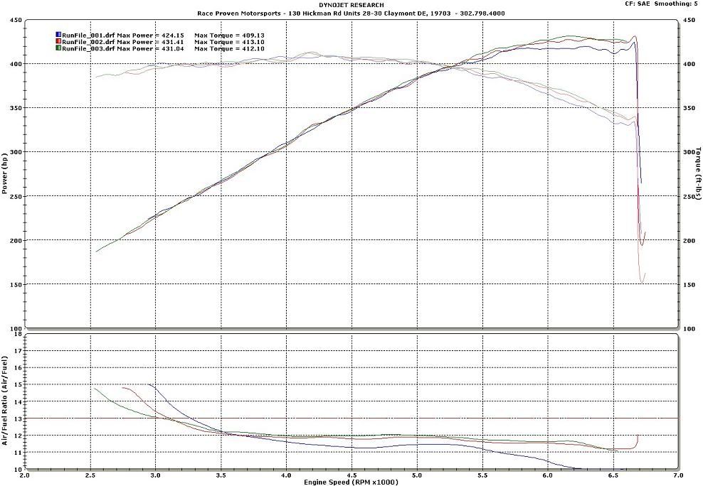

Here ya go. My IATs were 165* and probably pulling several degress of timing.
Roshan re-tuned it after the first run as you can see, my broken IAT had screwed some things up. Still couldn't get past the old numbers.

Yeah, logging my runs would have been helpful.
I think my issue can pretty much be attributable to the IATs being so high. Besides pulling timing, my A/F is quite a bit richer than yours toward redline. Check it out, where you stay right at about 12 all the way up, my starts getting richer at about 5000 rpms and up. That's why my tq and hp start to fall off and yours stays up. Roshan also kept my tune on the safe side from the start as I was approaching 7 psi and have I no desire to blow anything up.

All my runs on the run files were a bit higher,,,,you sure you didn't have them fudge my numbers? ;) I couldn't find the torque in the run files.
Next meet needs to be in cold weather. We'll be up near Randys numbers :D

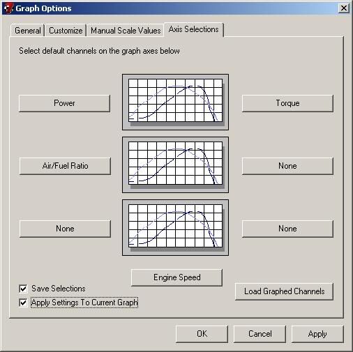

Are you sure you didn't change the correction factor from SAE?
Right-click the graph and choose "Properties..." Change the Axis Selections tab to look like this:
You can also adjust the manual scale values for the A/F graph if it doesn't show right.

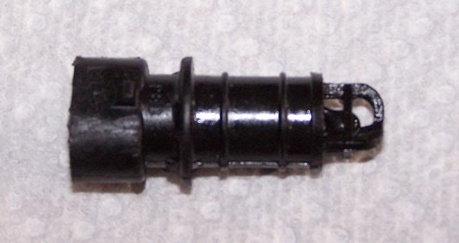

Can you take some pics of the sensor. I'd like to see what it looks like w/out taking mine off. I PM'd the guy a little while ago.

Sure. The sensor was about $12 from lingenfelter. It's GM Part #12160244.
As you can see, it's just a little thermistor (or whatever they're called) protected inside a small plastic cage.

Thanks, just ordered it. Did you happen to notice how deep the hole was under the sensor.
Which hole do you mean, where the actual sensor is or when you plug in the pigtail connector? I couldn't get an in-focus closeup of it because my camera sucks.
The one in the blower. When the senso comes in, I wanna see if I can get a longer thermistor on. Or at least one that can adjust as quickly as the air temp going through it.
