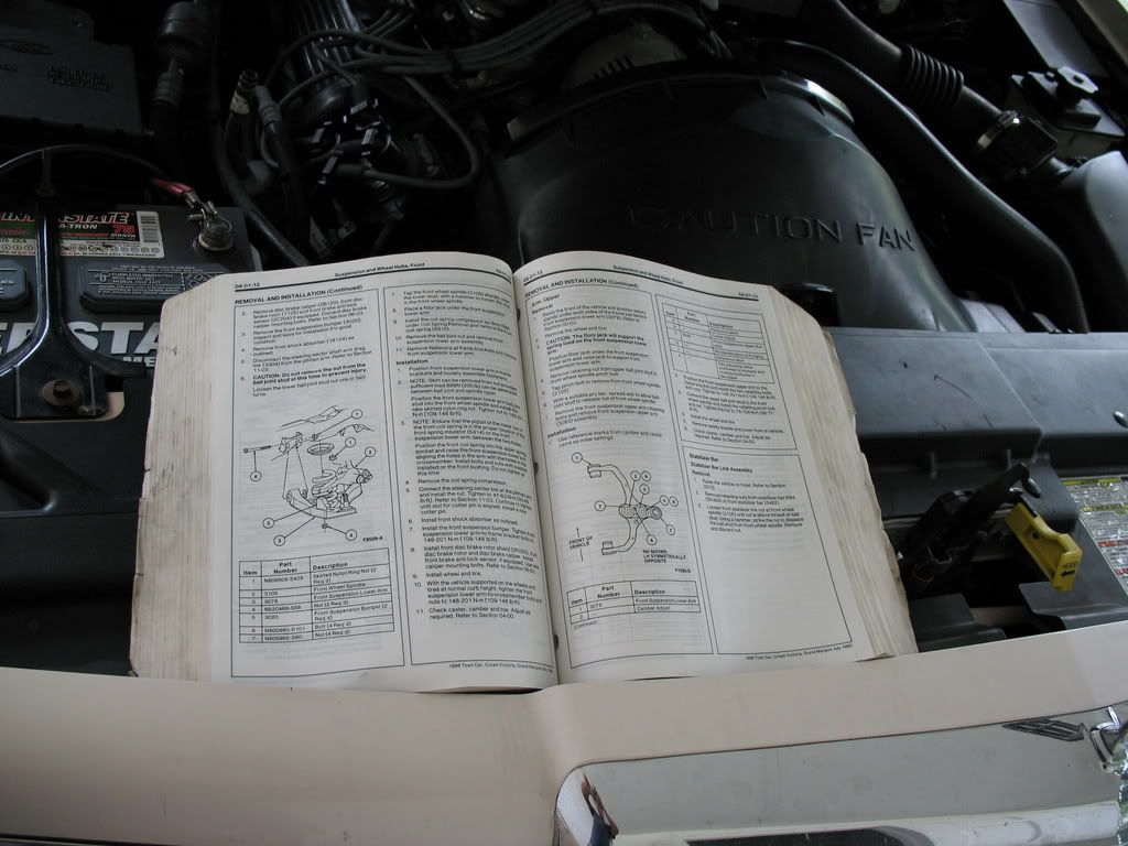

Ah yes, factory maintenace manuals :)
Yeah, I've already been in there to replace all 4 sway bar links, all 4 ball joints and all 4 tie rod ends.

At first I thought I had to remove the entire spindle, but then I was reading the book and it said that basically as long as the upper A-arm is left connected to the upper ball joint, it can stay on, but to remove the caliper and rotor and stuff.... well I took that one step further right now, and decided to work around it, with the caliper and rotor still on :) I *thought* I was going to replace upper A-arm bushings too... but forget that right now... I am not even sure if I want to attempt the right side LCA bushings right now! (though I'll probably do them)
