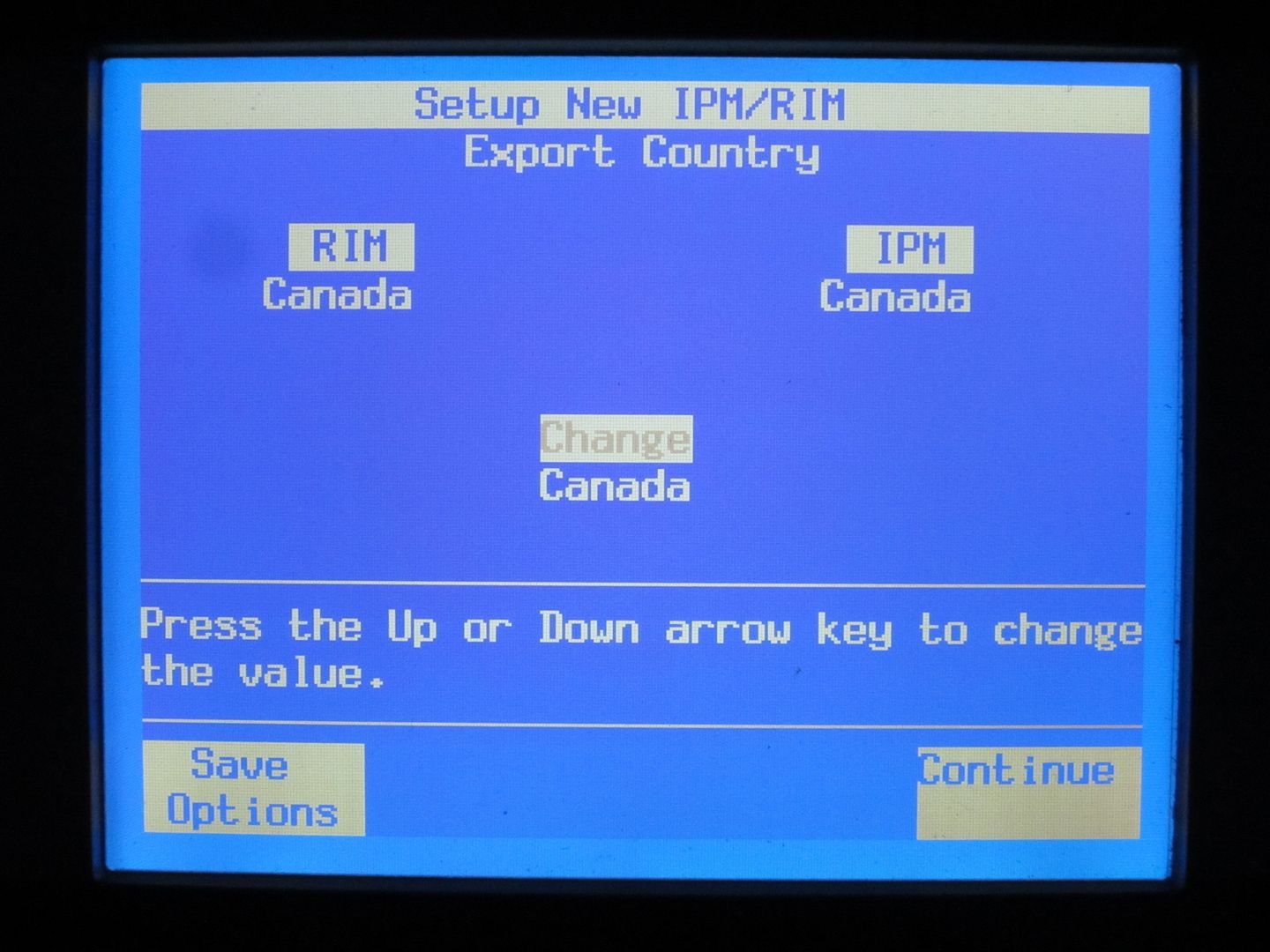

Here is the screen where the programming change is made...
I have trimmed your info down a bit and printed it so I can take with me to help them. I take it they would just need to change the bottom entry to be US and then save and it would then reset both RIM and IPM to US?
Hopefully the part about many dealers not being too smart :) LOL Yes, the country can be changed and the settings saved without the need to alter other configuration items. Changes made in the IPM are automatically updated in the Rear Integration Module as well. The RIM stores a backup copy of the configuration information.
