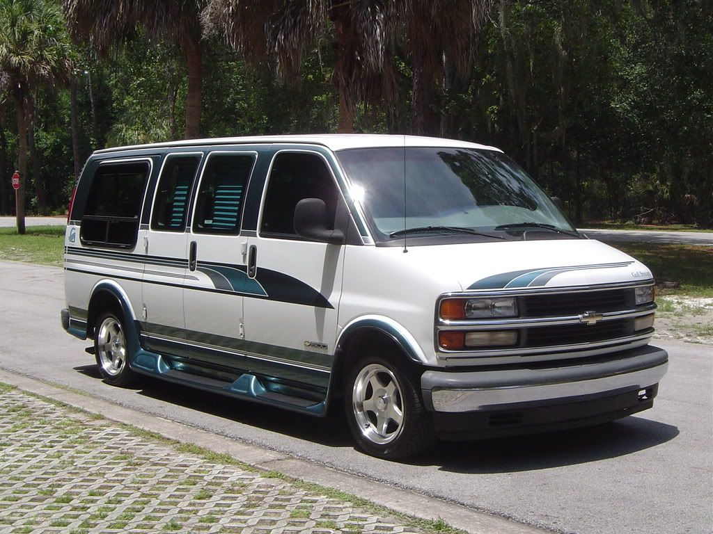

Bought this '96 Chevy van a week or so ago. Its a conversion with a lot of decals. everything that is teal aside from the bottom spoilers is a decal. I'd like to remove them. Any advice on taking them off?. I tried using a razor and a hair dryer on a couple of spots but that would take forever plus I dont think it would come out too good. A friend told me about an attachment for a power drill that would strip the adhesive right off but is not sure what its called. Any tips?. Thanks.

I removed the signage from the sides of a 7500 gallon aircraft refueling tank truck using a hair dryer. Park the thing in the sun and get it good and hot. Use the hair dryer to get it started with your fingernails or a plastic picnic knife and slowly pull. It comes right off in sheets. Try several different angles as you pull out from the surface. Your technique will be pretty refined by the time you get to the second side. Once you get started don't stop. Sometimes getting it restarted is more difficult than the original try. It's like the sticky stuff cures or something. This is not rocket science. A couple of hours of your time and you're home free.
