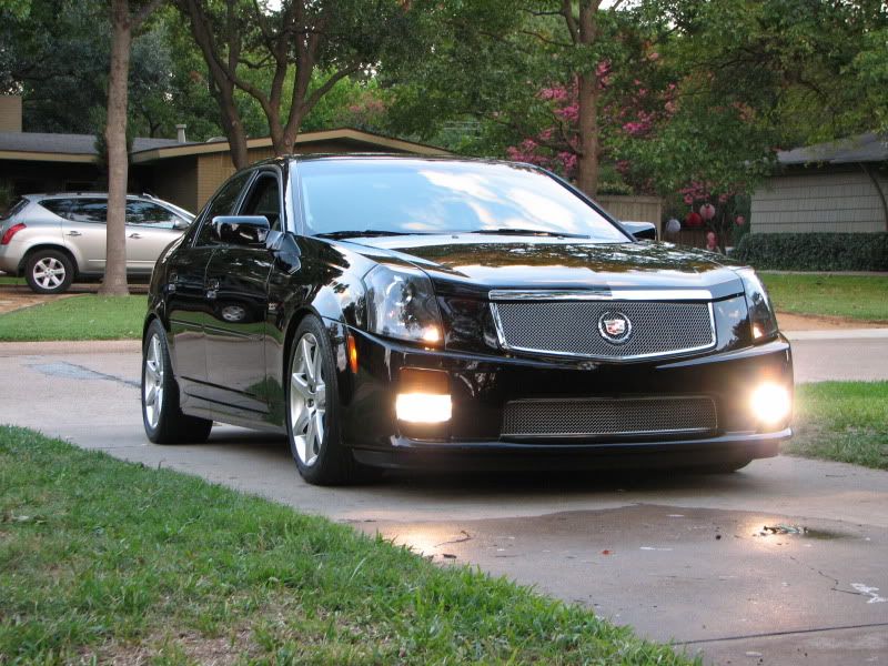

If you have lowering springs and the rear of the car is pumping up this is what you need. I made a set of these for my car when I had H&R's on it and it worked out great.
I should have the first run of spacers in about 2 weeks. The set should be in the $30-35 range. If you are interested let me know and I will start a list.
Here is a picture of my car with the H&R setup and the lowering spacers that I made. The car pumped up about a 1/4" after driving but I will be making the spacers a little taller to compensate for that.

Not that I need them. But will they be one size fits all, or will people be able to alter ride height? Don't know if eibach and h&r are the same size.
Just a thought.
2005 CTS-V
315 Posts
For now they will provide about a 1" difference. I can supply a washer with the spacers for the eibach springs if it does not sit at the desired height.
