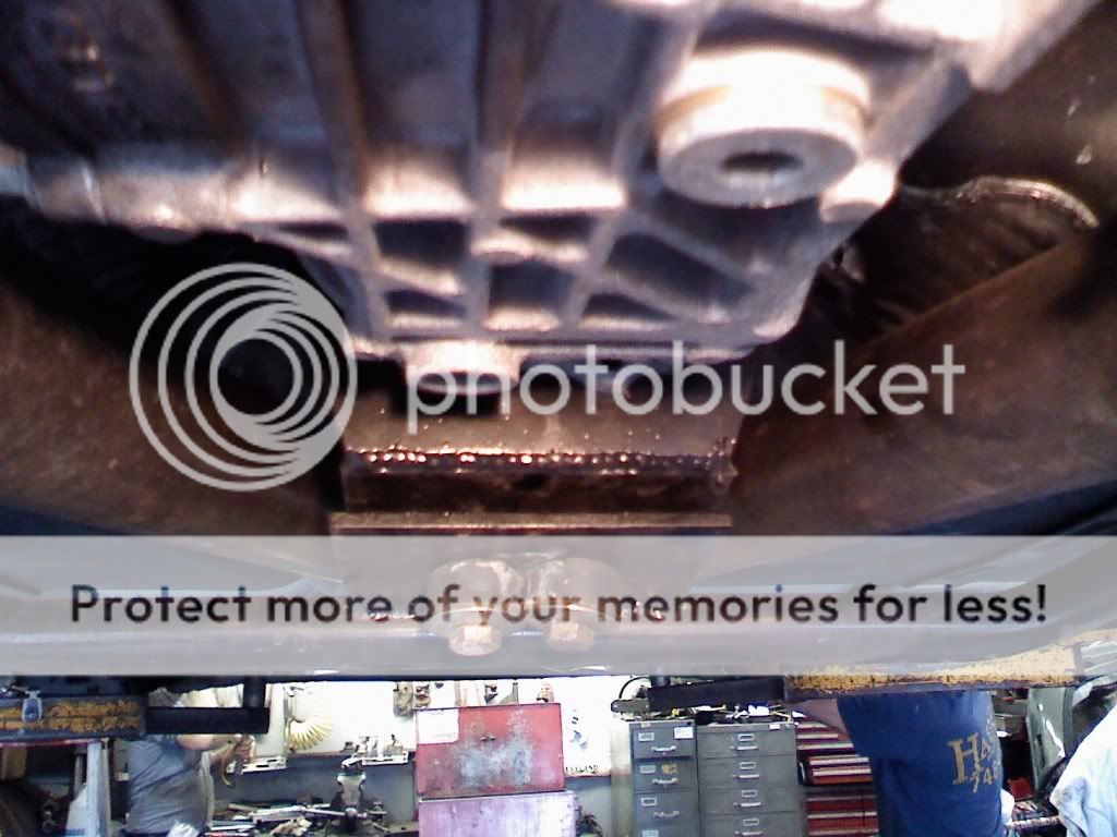

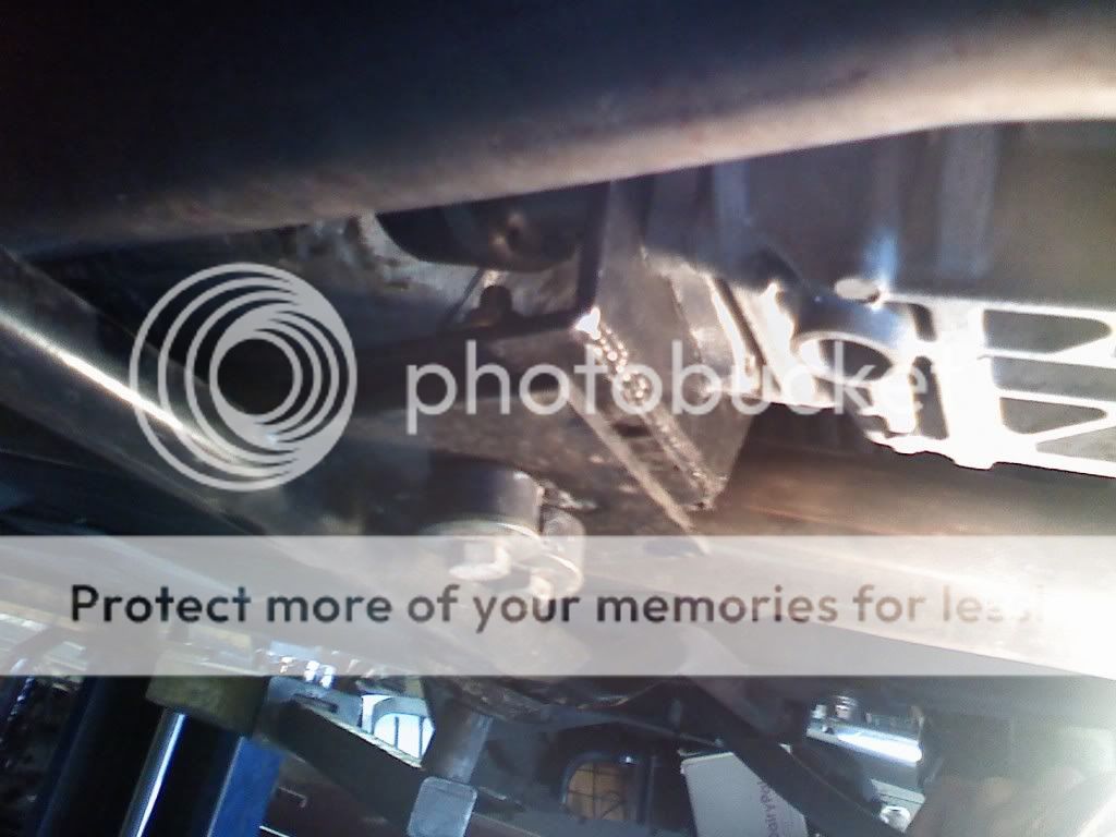

Just a question for all you guys with a KARS III kit on your car. I had mine put on by Lindsay while I got my new 07 diff a few months ago, and was wondering if yours looks like this. I never noticed this gap before. I was bleeding my brakes with some fresh RBF today, when I noticed it while it was up on the lift. I'm pretty sure this needs to be tightened down, right? :hmm: Also, could this be making my clunk even worse? Here's a few crap pictures below taken by my Voyager.

Mine looks the same way with a huge gap like that. It doesn't seem right though. You'd think it should be flush.
And Randy, I cant find that thread. Are anyone elses different?

ya i would have expected the bushing to go between the plates
Yep. Those others appear to be done incorrectly. That really sucks, are the techs that stupid that they didn't realize that the bushings usually go between to pieces of metal, not on the outside like washers, my god...

I would have thought it would have been:
Bolt, washer, bushing, plate, bushing, attach.
Why stack the bushings?
Me too. It doesn't make much sense. I'm just second guessing myself because Lindsay put them on and they've never done me wrong. But mistakes also happen. I'm probably going to put a call in to Luke and see what he says about it :confused:

Geez, mine could be totally wrong. Doug's "instructions" were a bit lacking in photos/drawings/etc. Why have such long-ass bolts, then?
I've posted up several pics before, and nobody said a thing. Well, I don't feel so bad if Lindsay did it that way, too. Tweeter's install looks like it may indeed be the correct way. (Too bad it's so dirty! :histeric:)

From Doug's mouth: There is supposed to be a gap. It goes, bolt, washer, bushing, plate, space, plate, bushing, washer, nut. You need to tighten to bolts and nuts just so to "lock it in place." If you tighten it all the way down, you will change the pinion angle therefore erasing the need/ requirement of the kars kit.

LOL Randy. I did't say anthing because those bushings had a shoulder on one side so it makes the most logical sense to install them that way... with two bushings (4 total) it's the only thing that makes sense man :)
