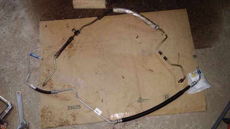

so, today i reveive my steering pressure hose, so it's time to change it ! :D

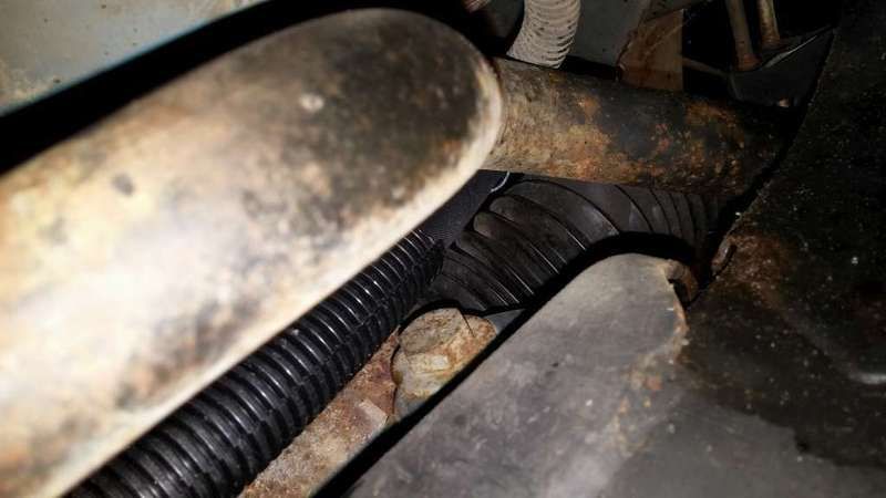

hello,

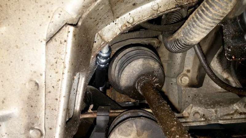

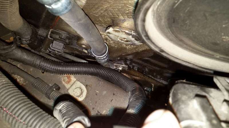

1) Steering pressure hose
i have replaced the steering pressure hose today.
it seem the hose has changed, so need to reroute it...
but i'm not happy with this...
i think hose is too close to steering arm..
Hose is no more attached behind the heat shield..
very close to head too..
what do you think about that ? is it normal ??

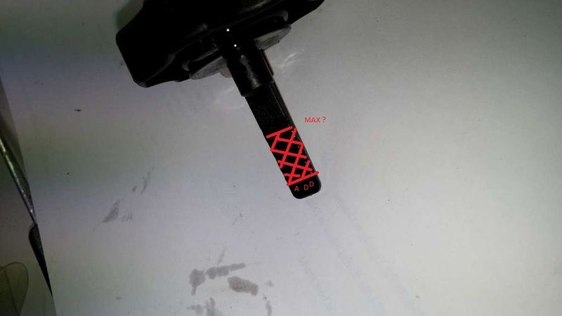

2) Steering fluid level
now, what is the correct level for the steering fluid ?
is the maximum level is at top of hatched zone ? like a put on picture ? (i say this because under this zone, there is a "ADD" mark.)

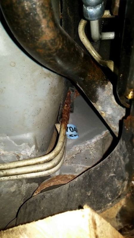

3) Rust on fuel lines
one more question... i discover that the fuel line under car are rusty ! :( :(
what can i do for this ? do i need to change the 3 entire lines ? can i change only rusty part but how to do this ? (never done that)
where to buy ?

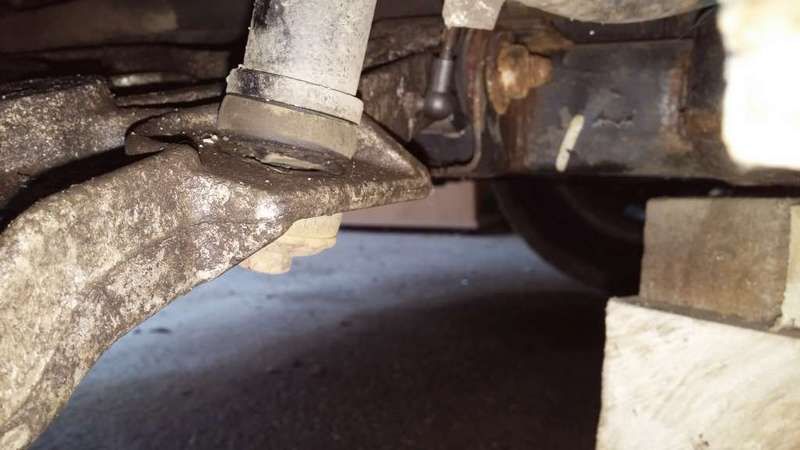

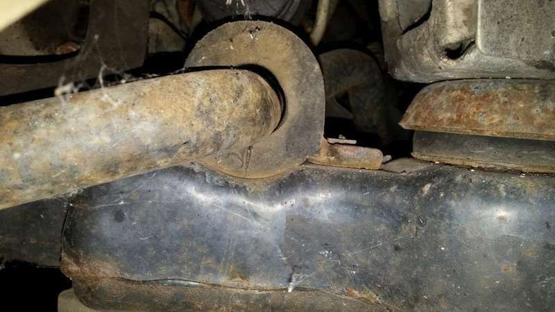

4) stabilizer bar
is it normal ?
bar link seem to be bad too ?
do you think i need to change them ?
thank you !!
98 DeVille, 97 DeVille d'Elegance
8,615 Posts
The PS hoses may have been redesigned over the years, someone may know updated parts numbers. There were issues will low speed growling being transmitted through the lines.
Not good on the fuel lines, you can patch and they sell end kits, I'd get on the soon and while your at it check your brakes lines especially in the rear.
Yes on PS level.
Those sway bar bushing look worn to me.
2001 Seville STS, 1990 Seville (RIP), 1972 Sedan Deville
26,328 Posts
Yeah the bushings and links are worn.
The cross hatched section on the power steering cap/dipstick is the hot operating range. As long as it's in that range when hot, it's fine.
where can i bought the bushings for this cadillac ? (not found on Amazon and rockauto)
for link i have found this one. is it good ? (not axactly the same... :s big plastic spacer no long exist..)
ACDelco 45G0015
ok ! on cold i must keep the level to bottom of hatched section ? i don't imagine how much the fluid expand..
do you know where i can bought this kit ? and how it work to make the "patch" ?

As for checking the power steering fluid level, you check and adjust it when hot. The reading when cold is irrelevant.
