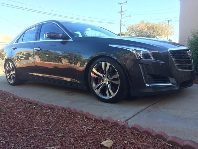

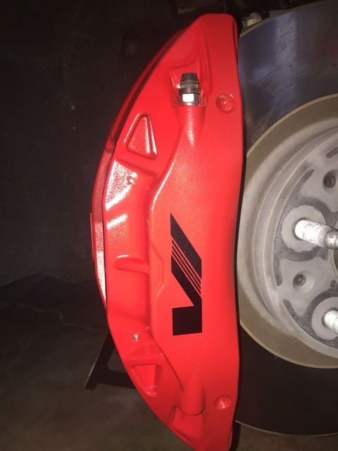

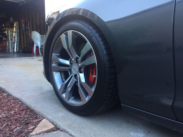

So I decided to try this. Doesn't cost much but time. I also had some custom VSport logo decals made. Only did the front for now, I'll get to the rears eventually.
Heat tests tell me the plastidip will hold up in normal driving in my moderate climate. At worst, an over temp will result in oranging of the red. No loss, just peel it off! I'll powder coat some day...

I'm personally not a fan of V decals on a VSport, so I made vector images of the VSport logo. You can find them in this post: http://www.cadillacforums.com/forums/cadillac-v-sport-appearance-mods/910673-vsport-logo-vector-images-decals.html
These images are sizeable without distortion, but the link on the post is correct size for VSport calipers. I used vinylstatus.com for decal printing and they have held on for 5000 miles so far and don't look to be peeling. I will say, the rears will not stick unless you grind down the caliper casting lines to make a smooth surface for it to adhere to.
Also, the plastidip will lift in those little cutouts/crevices in the caliper IF you don't clean them REALLY REALLY well. I had some lifting, peeled out and blended those sections with mineral spirits and re-sprayed. Would have saved me a lot of time had a I cleaned those hard to reach areas with a Q-tip first.
