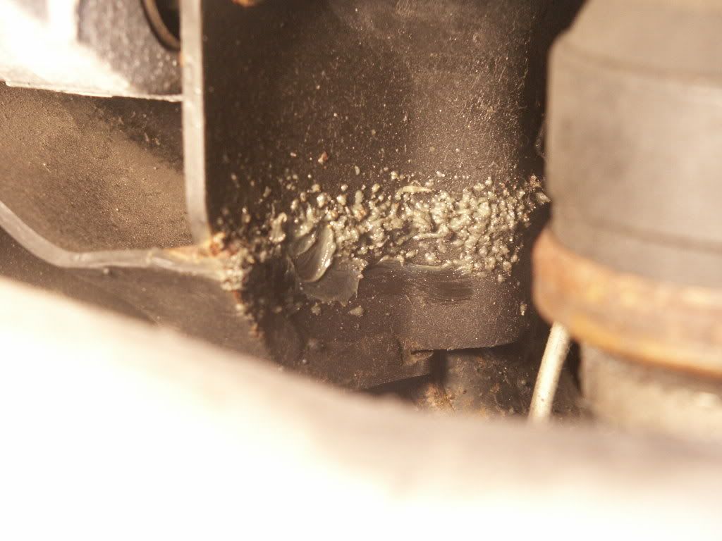

Got the car up on jackstands today to ponder doing the diff bushing replacement and see not only what looks like my pinion seal has sprung a leak, but there's grease being flung off the inner, driver-side CV joint.
Pictures aren't the greatest, but can anybody confirm this/these? I'm off warranty, too ... has anyone done a pinion seal replacement themself?
Grease being sprayed on underbody:

· 2016 ATS Premium 6-spd MT
14,538 Posts
Discussion Starter · #14 ·

Am on my way to Den_93's buddy's house to have him change out my diff bushing ... he's got a lift :drool: ... and I'll take better pics when I'm there and post them up.

That looks like grease from the CV boot...too thick to be the diff fluid. I went thru the same exact thing on my 1st driveshaft. <- Might be time for a new driveshaft Randy if you don't have those crazy ewill tools :cool2: You couldn't even see the rip in the boot unless you grabbed it and torqued on it. Then it slowly flung out like yours looks like it's doing.

Ewill was right on the money. Just got back from having my diff bushing installed. It turns out that the band clamp was installed (I assume at the factory) on a slight angle. I could actually wiggle it with my fingers. The guy who did the diff bushing (great guy, btw) straightened it up and was able to just barely tighten it with some visegrips. It's a bandaid until I can get a new clamp, and we'll put it on when I do the MMs and the FW.
This pic is not quite in focus, but you can just see that it's not quite straight (sorry, but photobucket is down, so this is straight from my camera at lower res):

Sometimes that metal ring that the boot mounts on isn't installed right, rare but possible.
If you are on that "leak" you should be fine. Yeah that clamp isn't installed right, I can tell from that photo.

It took like 1-3/4 hrs but we also mended the CV joint clamp, plus he tack-welded the steel plates onto my KARS III kit. Actually, I think I'm going to have him do my MMs and FW installs, maybe a pinion seal and maybe the CV joint clamp and ... well, that's all I can think of at the moment. :D
... If you are on that "leak" you should be fine. Yeah that clamp isn't installed right, I can tell from that photo. ...
Crappy pic ... wish I knew how to put those nifty little arrows guys draw sometimes to isolate what they're talking about. :banghead:
