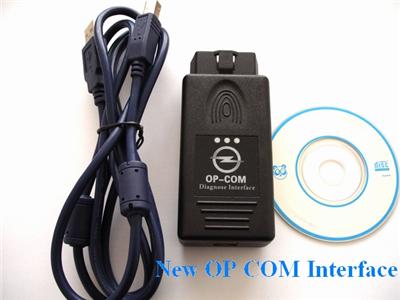

I just purchased one of the OP-COM units that you can find on eBay...
It cost me 40$, shipped to my address. It is not quite here yet but as soon as it arrives I will post pictures of it and write up a small review of what how the too performs....
Sounds like the unit can read DTCs as well as program keys, remotes, and possibly change things inside the BCM, things like when teh doors lock, or when the headlights turn on... etc...

Just received this unit, installed the software but for whatever reason my ECU wont allow information to the device, I will keep trying however nothing is certian yet...
Just to verify the Catera is KW2000 correct? Or is it a CAN?

I have been told that the Catera is KWP-2000 which means it will work but my unit is defective and I will be sending it back for a replacement, then i will be trying again...
When connected mine clicks as if a relay is bad inside and it gets into a confused loop mode where even the laptop doesn't recognize it...

I just received mine, installed the software and hooked it up to the car... So far I was able to read trouble codes (none found) and measuring value blocks in some modules... Certain modules I need help on is the central door locking and immobiliser.. I guess a 4 digit security code is needed... I don't have one, So I sent an email to the designer of the program asking for help.. So I have to wait and see what he says.. I will keep you guys posted.
