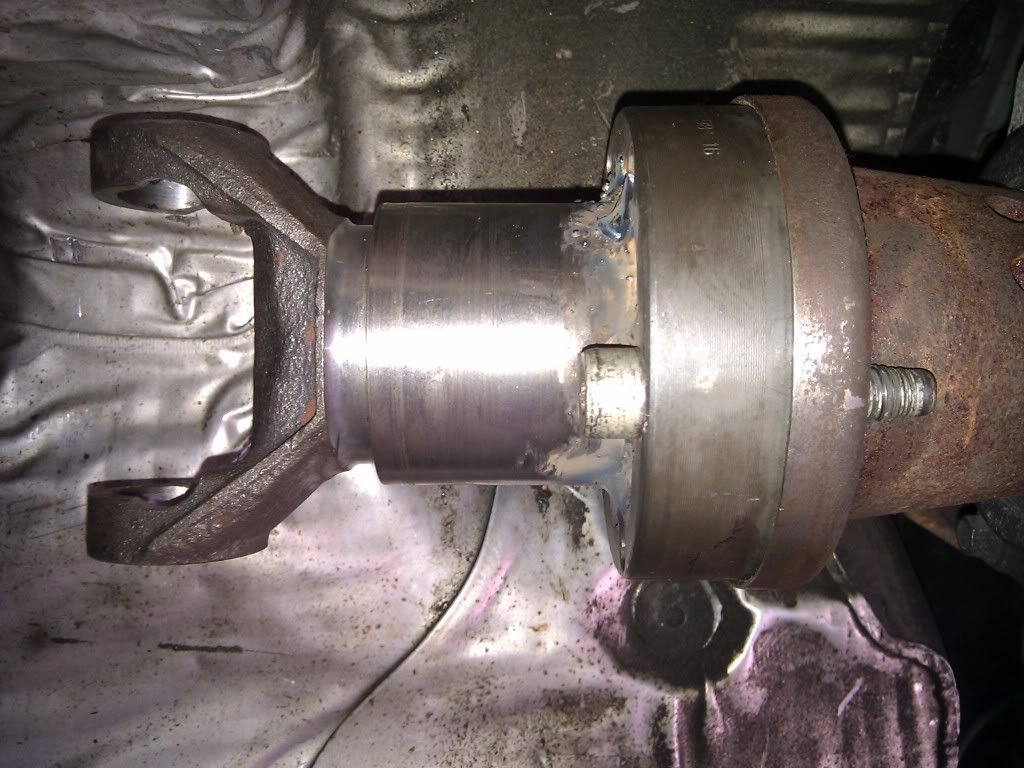

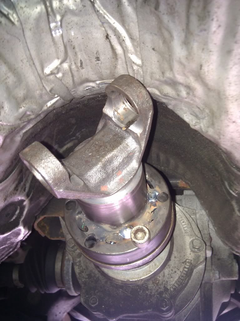

I had a local driveshaft shop install a one piece driveshaft for me three weeks ago and it works great with no vibrations at all. I wanted to make sure that it was vibration free before I posted, because I know in the past there was a little debate about using a one piece in the V. He “custom “ made it by doing a little Frankenstein work, using the part of the stock driveshaft that attaches to the diff and mating it to an old 3” shaft that he had laying around. After removing the diff end of the drive shaft he inserted a short piece of steel tubing and welded it. He then balanced this piece by itself and made sure it was true. This worked great because it was essentially the “old” driveshaft end going back into the diff so it was perfectly aligned. Pic 1 & 2 shows what I mean
I had two issues when it was first installed. I had a bad vibration that turned out to be that my tires were out of balance. Took it to Firestone and had them road force balanced and aligned now it’s smooth. The other issue was that under really hard acceleration and quick shifting the diff end of the driveshaft would flex and briefly touch the body. This only happened when shifting aggressively, so I called Max and picked up a CS diff bushing, problem solved no more flex. The car now drives so much better. Now when you shift it engages right away with a positive feel. As soon as you let go of the clutch the car moves. Plus no more clunking.
Pic 1 tube welded to old DS diff end
Pic 2 How it looks installed
