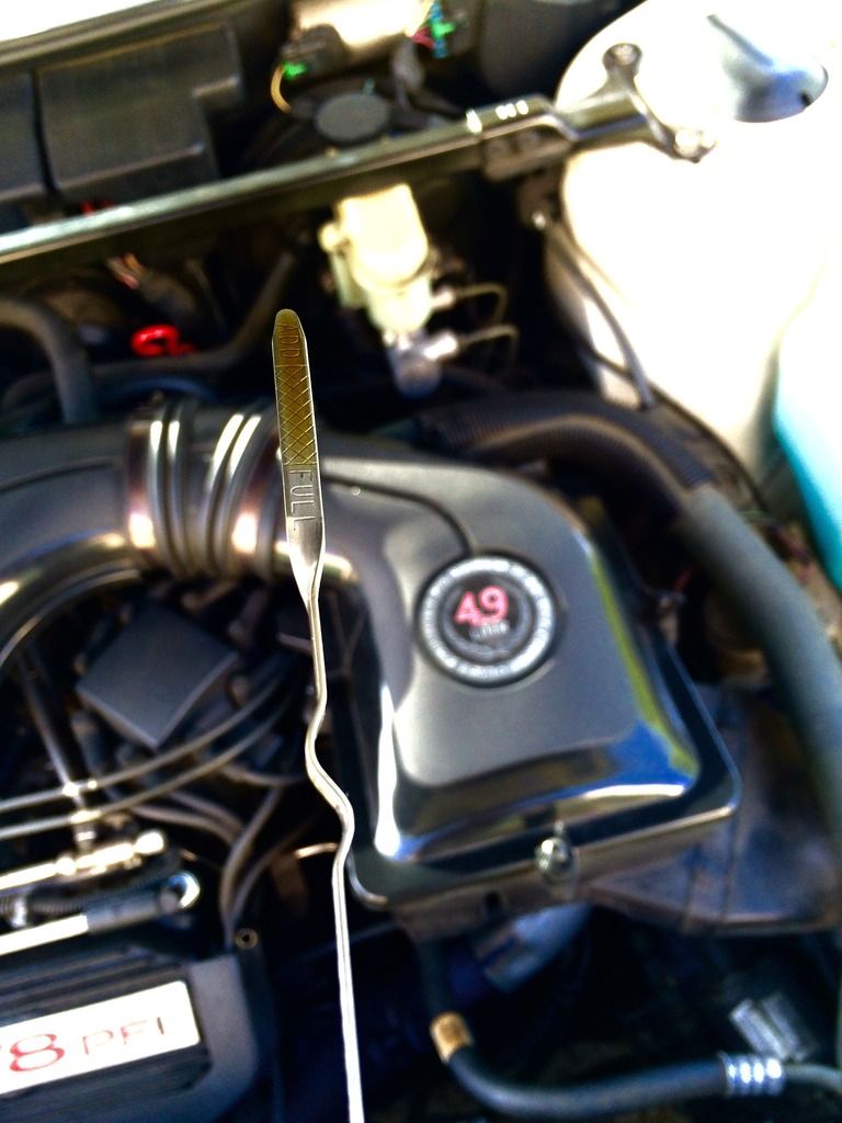

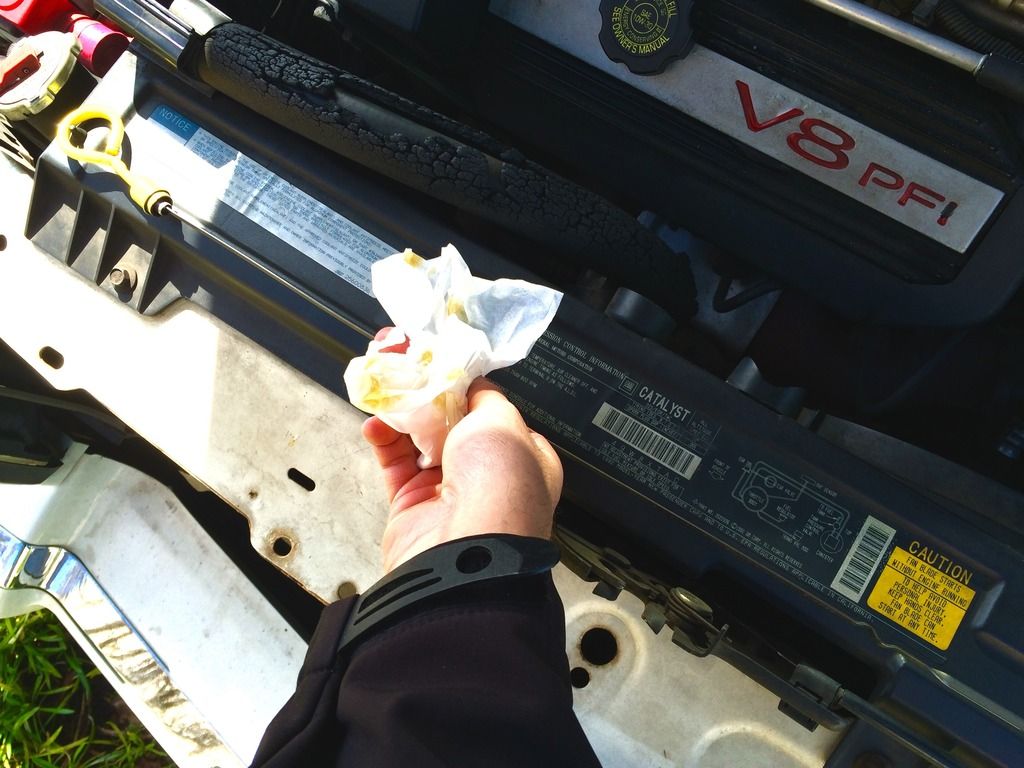

Here's a pic after I drove 20 miles to work. Car was sitting for about an hour and a half.
Also, dipstick length reference. About from the nipple on the radiator cover to the blue and silver sticker on the right hand side of the same cover

The oil capacity of the engine is exactly what it says on paper. There are no variances between individual vehicles.
If it's taking 6 quarts, something's wrong. Wrong oil filter, wrong dipstick, sits tick tube not seated correctly, oil not draining into the pan for some reason...
