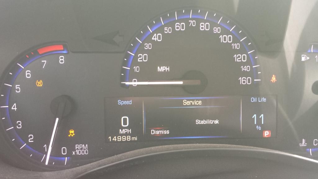

My gf has a new ATS, and yesterday she said it wasn't driving smoothly. We just put a couple thousand miles on it on a roadtrip last week. On her way to work this morning, it continued, and the TC off light came on, and pressing TC button doesn't turn it back on. Additionally, now it says service stabilitrak.
Is it safe for her to drive it? She has an hour drive home, and then another 45 mins to the dealer we bought it at. (We need to go in to get the title and plates also!)

I hit a pavement groove yesterday where the new pavement was meeting the old and I didnt see it. Pretty hard hit but it didnt seem like the suspension bottomed out.....about a mile later coming to a light I noticed my stabilitrak light was on along with the traction control off light similar to the OP. I have a '13 ATS premium 3.6 AWD. In reading through this thread it seems most of the rough idle and piston issues are related to the 2.0T and my car seems to run ok. I checked the manual and it says if that light combo comes on to have it serviced but doesnt warn against driving the car. Normally I would just call the dealer service dept but they are closed today but just curious if I should be driving the car? Has anyone else had this condition with the 3.6 and still drove it without any issues? Seems like it was directly related to hitting the bump in the road but not sure why that would trigger the Stabilitrak unless a sensor or something popped loose. Any way just looking for some feedback cause I want to drive it but dont want to damage anything further.
it could be a false fault. Try turning the car on and off several times to see if the warnings go away.
My thought is that if Stabilitrak and/or traction control are disabled, they are not there to help you if slipping ot skidding, but otherwise I think the car should drive OK without hurting anything. Note that they can be turned off on higher perf cars and I think TC on any ATS can be turned off, so I doubt you can hurt anything. Just be more careful if slippery.
It shouldn't hurt to continue driving it and there is likely damage to a sensor causing the safety systems that rely upon that sensor to shut off. With a hit like that followed by error messages I would suspect a wheel speed sensor but usually that also triggers an ABS system warning if a wheel speed sensor is out of tolerance. As Art noted just drive more carefully until you get it to the dealer since stability control is now turned off; of course watch your acceleration -especially on wet roads- until you get it to the dealer.
Have the dealer take a close look at the tire and wheel that hit to check for any damage and have the tire balance checked. A really hard hit can damage the bearings in that hub assembly and if that occurs the wheel speed sensor will no longer indicate properly.
Reactions: 2
Thanks for the feedback.....i shut it off and on at several different intervals and it didnt go away but then decided to drive it and after a few miles the lights went out and everything seems cool now. Still trying to figure out how a stabilitrak / TC warning has anything to do with rough idle conditions...weird:)
Stabilitrak and TC rely upon controlling engine power as a major part of their ability to reign in the vehicle, first by retarding timing for slight power reduction and closing the throttle when more power reduction is needed. If the engine isn't running/responding properly then the calibrated control algorithms won't work as intended and the intervention could make the situation worse and not better. So if there is an engine operation issue these systems will turn off and the system malfunction warning is displayed. Other failures within the system, such as various sensor issues, will also cause the system to turn off but if it cannot rely upon the powertrain to respond as intended then it has to shut these systems down.
When the current generation Corvette was fairly new in production there were several incidences of Stabilitrak/TC turning off and it was due to spark plug coil wires that weren't properly seated during production. Although in several cases the owner didn't feel the change in engine operation/performance it was sufficient to cause these "nanny" systems to shutdown.
