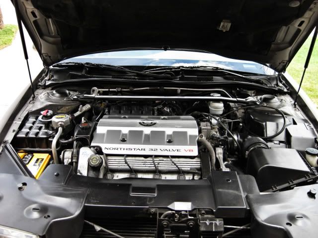

oh its what blocks you from the radiator drain plug right?Roll over on your back and stick your head under the radiator. The entire front lower area is sealed by a plastic molded "splash shield" which runs from the front bumper fascia shelf to nearly the front of the engine. This arrangement routes all the grille air through the condenser/radiator and back over the front exhaust manifold, up and over the engine and down the firewall. The sidewinder engine needs the airflow for partial cooling, thence the air dam.
Look at the flaps at the front sides of the radiator - part of the same arrangement.

That may describe the 98 and later Seville, and 2000 and later Deville configuration but the 97 and earlier Sevilles are a little different, and I'm assuming the earlier Eldorados are the same. My 97s both have a narrow rigid plastic air dam located below the radiator between the radiator support and the front of the engine cradle. Between the lower edge of the front bumper and the front of the core support is a heavy flexible air dam made out of the same stuff that is on either side of the radiator (sort of a rubberized canvans sheet about an 1/8" thick). It is held onto the bottom of the lower edge of the bumper, and the radiator support by plastic push pins with large heads (about an 1 1/2" in diameter). I can snap a couple of pictures of the one in my white Seville, as its hanging by one of these push pins, until I put the engine back in this weekend.Roll over on your back and stick your head under the radiator. The entire front lower area is sealed by a plastic molded "splash shield" which runs from the front bumper fascia shelf to nearly the front of the engine. This arrangement routes all the grille air through the condenser/radiator and back over the front exhaust manifold, up and over the engine and down the firewall. The sidewinder engine needs the airflow for partial cooling, thence the air dam.

That's exactly what i'm looking for, there are actually 3 pieces I believe, as the side parts protect the condensor/alternator on the pass side and the PCM/trans cooler lines on the driver's side. I found one on a 96 in the junkyard but it was missing its front wheels and was resting on it, hence I couldn't get the push pins out for removal. Car-part doesn't have a listing and I've asked caddy specific parts dealers and they don't know what i'm looking for, but I located a 95 MY in a pull-a-part that's good about putting cars up on stacks of rims so you can get to all the underside bits, hopefully it'll still be there and in-tact. If anyone has a part number on this I would be forever grateful, to date I've heard it called air-dam (which it's not), air straightener (which it kinda is but not), underbody shield (kinda is closer to the mark) or underbody splash guard. Since splash guard actually brings up real parts associated with the inner wheel well, that's close too. Thanks for all the discussion fellas, appreciate it...That may describe the 98 and later Seville, and 2000 and later Deville configuration but the 97 and earlier Sevilles are a little different, and I'm assuming the earlier Eldorados are the same. My 97s both have a narrow rigid plastic air dam located below the radiator between the radiator support and the front of the engine cradle. Between the lower edge of the front bumper and the front of the core support is a heavy flexible air dam made out of the same stuff that is on either side of the radiator (sort of a rubberized canvans sheet about an 1/8" thick). It is held onto the bottom of the lower edge of the bumper, and the radiator support by plastic push pins with large heads (about an 1 1/2" in diameter). I can snap a couple of pictures of the one in my white Seville, as its hanging by one of these push pins, until I put the engine back in this weekend.
