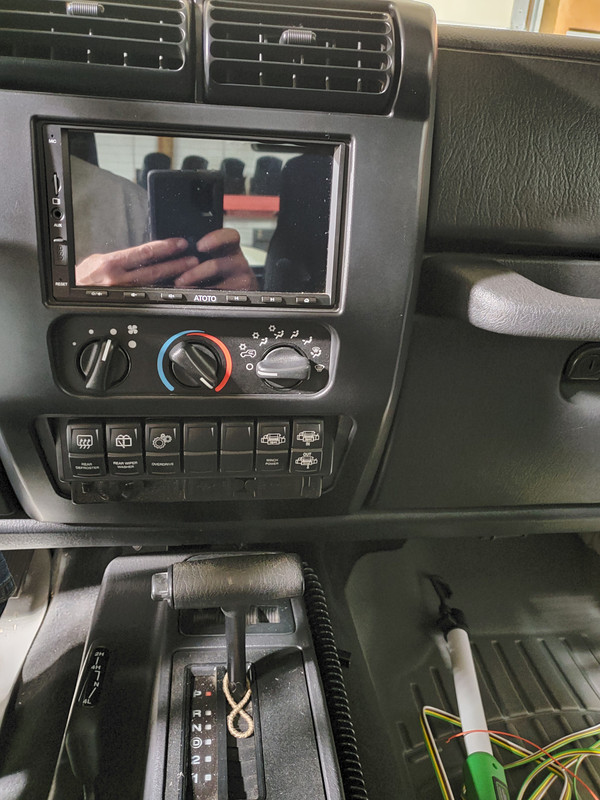

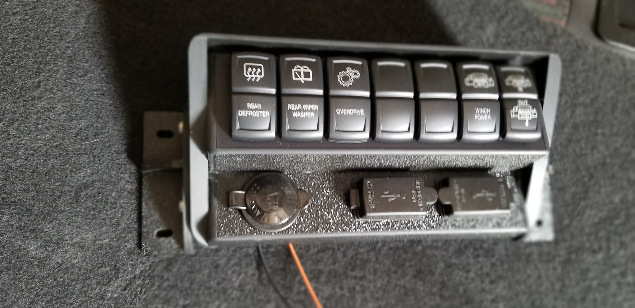

One can never have too many switches. I had this panel made last year and finally got around to installing it.

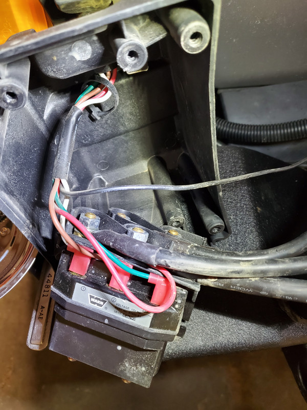

Turns out the easiest part of the install was the wiring for the winch, its a simple 5 wire system. I was able to wire the winch in the cab and still maintain the factory remote function, even though using a corded remote just became extremely primitive.
The jeep wiring wasn't quite as simple, but after looking at FSM and determining Mopar uses a neg trigger to signal the accessories, I was on my way!
I like it!! It somehow modernizes the simple TJ dashboard

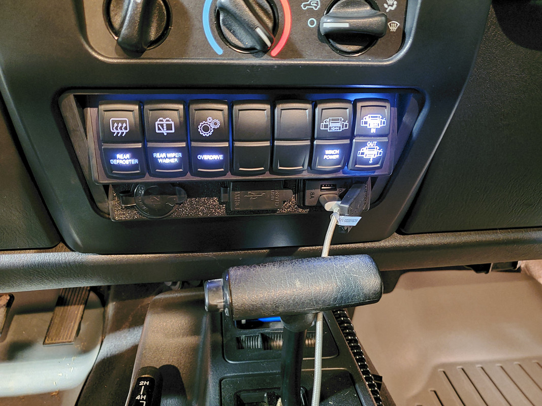

Lights on
Switches on. Its so lit, fam!
Since these LEDs aren't dimmable, I think I'll buy some spray tint and give em a light coating
