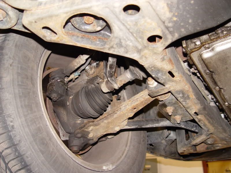

Hello. Earlier this week I had my 97 Eldorado up on the lift while I was replacing my front strut mounts and stabilizer links.
Before I did any work, I took some pictures of the underside of the car. Everything seemed OK except for a missing bolt that holds the engine oil pan to transmission bracket on.
Here's a pic:
Can anyone identify the size of the bolt, or perhaps a part number, so I can order one from the dealer? I haven't had any problems stemming from this issue, but I'd rather have a bolt in there than not.
Here are so more pics for your viewing pleasure:

The missing bolt is one of four that attach the transaxle brace. It looks like the bolt is no longer available thru the dealer but here's a description from the parts catalog....
Part# 337993 BOLT TRANS BR,HFH,M10X1.5X30,26THD,21.5O.D.,10.9,,(M10X2.5X30) (NOT AVAILABLE)
