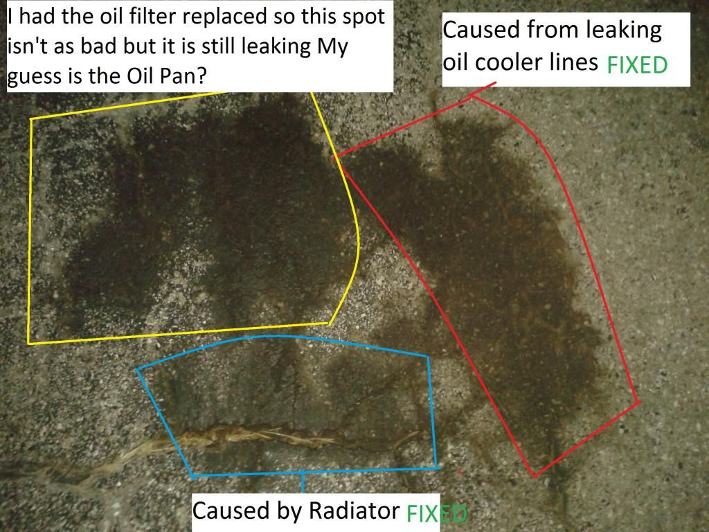

They pretty much all leak a drip or two, but I'm fed up with it, and decided to deal with it properly.
I did the intake manifold a few month back, and it and the front of the engine are dry as a bone. I have a leak that despite numerous attempts, can't be pinned down.
So I'm dropping the car with my local pro this coming Monday to replace the rear main seal, the oil pan seal, and the filter adapter housing seal.
Just want some opinions on seals, brands and whatnot. At this point I'm trying to decide rubber or teflon for the rear main, then it's between National and Timken. For the others I'll probably just get the Victor Reinz or Felpro top choices.
Any other problem spots I should ask him to look at while he's that far in?
