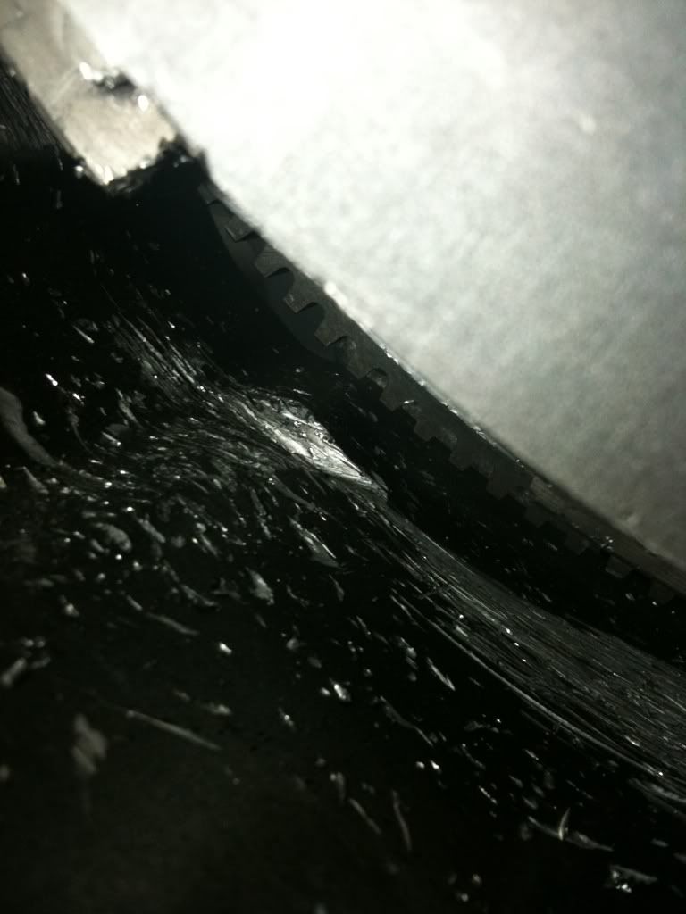

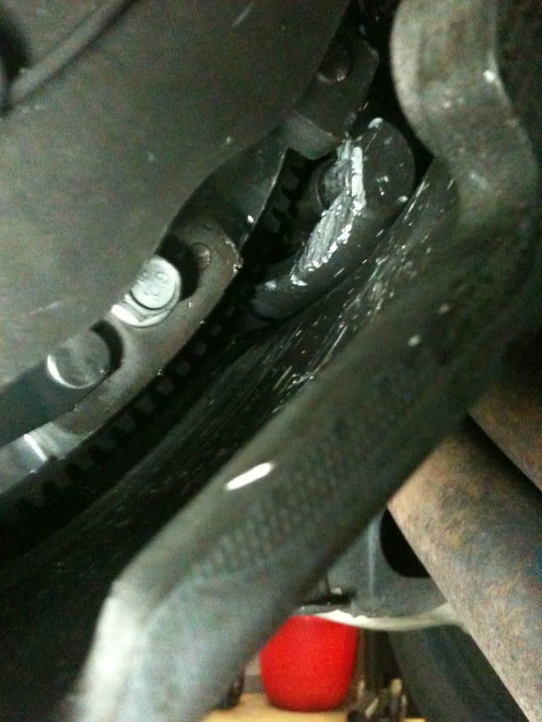

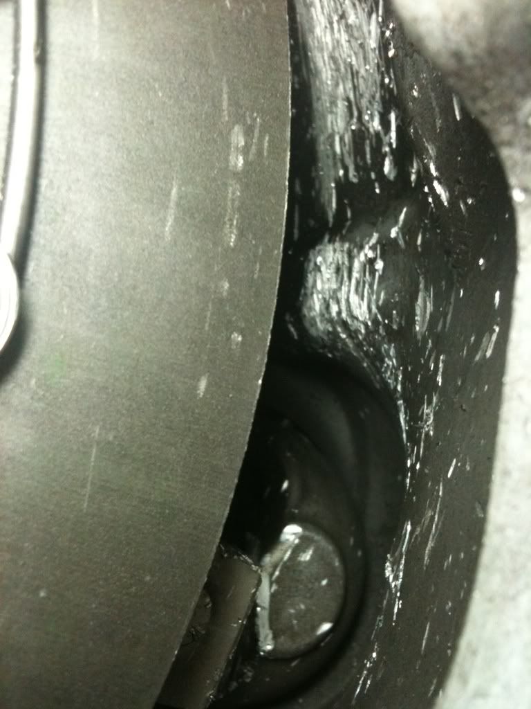

Broke the pressure plate last Tuesday night. One of the fingers broke and took out the starter housing and blew a couple holes in the bell housing.

That's an LS9 pressure plate that failed in 4th gear at 5500 rpm. It went 'bang' and I couldn't disengage the clutch anymore. I had to shift with the clutch the rest of the way home.

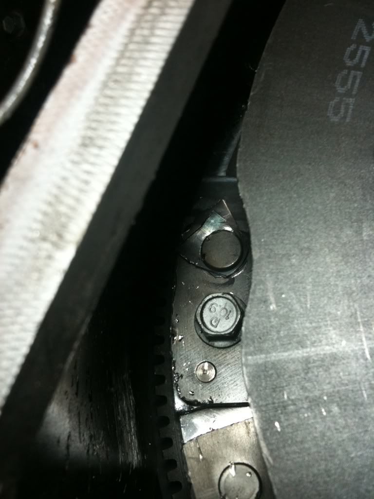

I am pretty sure it was a defective strap, although the other ones seem to have some discoloration from heat. At least after 3000 miles, the mating surfaces still look perfect.
Here is the discoloration.

Was it a finger or a strap that broke?
If a strap broke, then they must not be able to handle the torque.
With factory parts you almost never know if you got a bad manufactirung lot.

The piece that is discolored in the last photo above is what broke.
