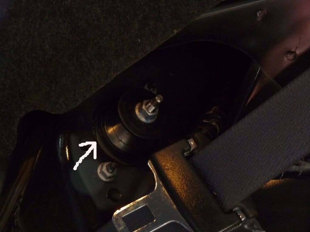

i would most likely need a set of these spacers, i have the GC, the rear is lowered, but i have the obnoxious clunk everytime i hit a speed bump, pothole, uneven roads.... i'd like to put one solid spacer on each side versus the feff fix that guys were just slapping 3-5 washers on both rear shocks... rc51 would your spacers cure the clunk issue?
I have no clunk but let me ask you a question, Did u tighten down the nut on the top of the shock as much as possible , and i mean smash that rubber bushing? Because that is what you must do to eliminate the clunk. If you did not then go and try that first because the gc spacers are 1 inch too correct? If so just do that and problem solved. I had the clunk with my 2003 cts with nels spacers but it was not nels spacers fault it was the guy who installed those did not tighten that bolt as much as possible and that resulted in the clunk. As you know you eliminate the rubber from one side and that is what makes the clunk because you have play in the shock but no absorber on the bottem side. Here are pics of how a smashed bushing should look.
