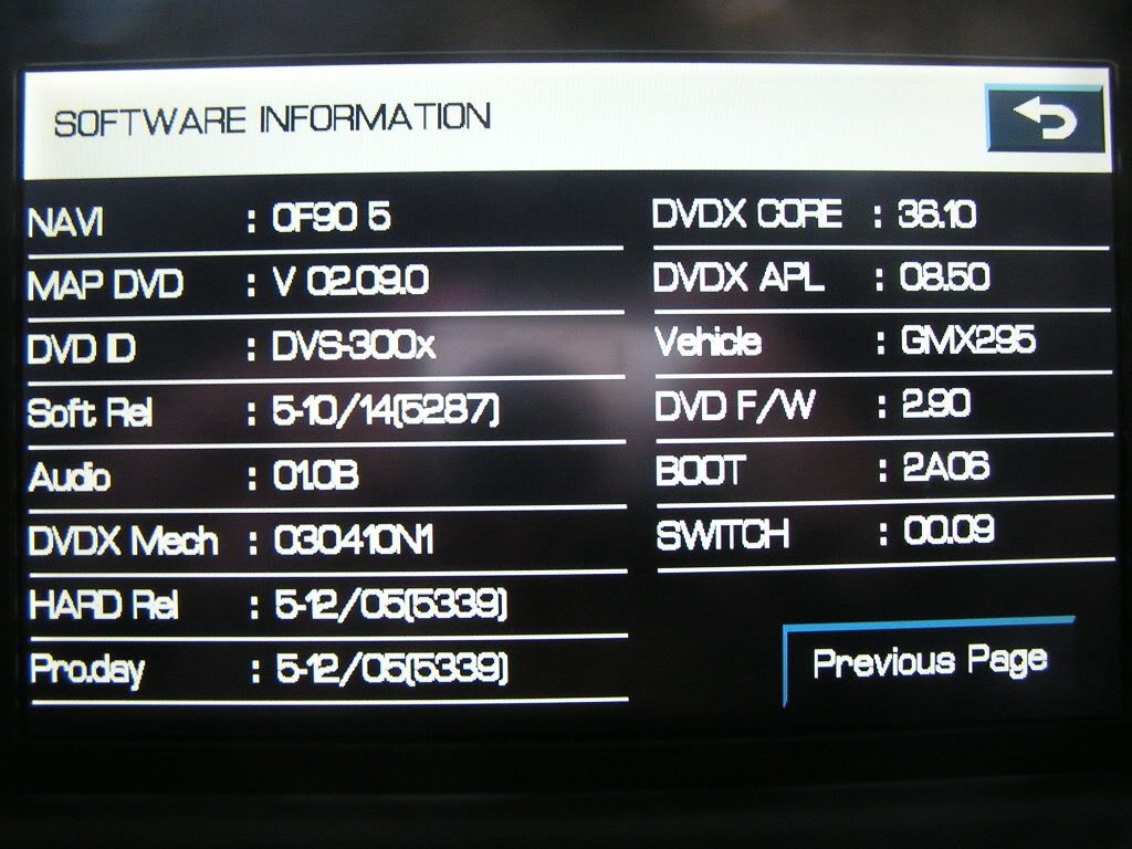

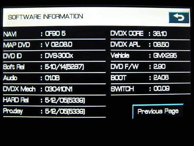

This is what I had on my 2006 before I got the new map DVD in the mail.
...and here is what it looks like with the new DVD installed...

If someone can tell me how to get to that screen I'll check. the dealer put a brand new navi/radio in my 06 today. I'd like to check what version they put in.
The short story:
Press the "MENU" button while on the nav screen...
Press on the area shown for about 5 seconds
When the keypad appears, enter "9448" and then press "OK"
WOW! My new one is completely different.
