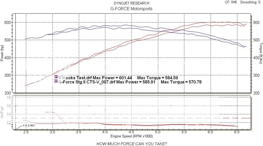

Just finished up dynoing my V. The results were impressive!
Mods before headers
LS9 Cam
9.55 Lower (14.5 PSI)
LPE Air box
Custom 2.5" Catback
Corsa Sport Mufflers
585 RWHP
570 RWTQ
Mod List now
LS9 Cam
9.55 Lower (13 PSI)
LPE Airbox
Kooks 1 7/8 Headers with cats and 3" x-pipe
2.5" Corsa Touring Mufflers
601 RWHP
584 RWTQ
So to sum it up. I lost 1.5 psi and gained 20 RWHP in places!!
KOOKS FTMFW!!!!
