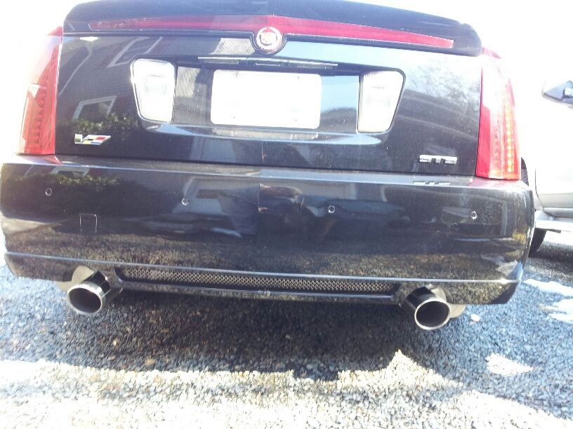

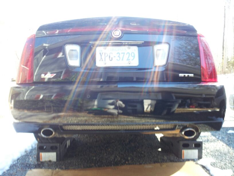

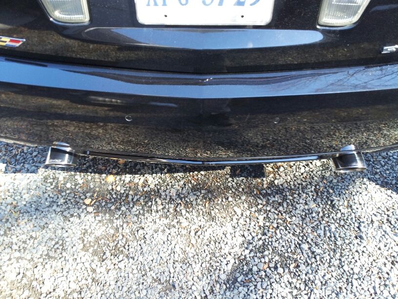

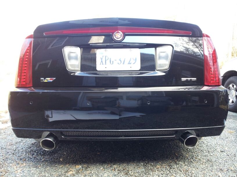

Some pics for comparison, excuse the lighting, bad sun angle for the time of day I was working on it.

Stock system from the rear for comparison:
Gibson System and the sagging driver's side muffler I'll need a shop to tweak:
Gibson system and the protruding tips (not a fan of):
Adjusted, still not perfect but getting there.

It isn't aligned properly, the thing is I spent an hour on that side alone and that's the best alignment I could get. The problem appears that the pipe isn't bent quite right in manufacturing which is why I think I'll end up having to go to a muffler shop to have them tweak it a bit. The only adjustments possible are sliding forward and backward and twisting the pipe at the point where it clamps to the stock exhaust.
I'm as far forward as I can go. I contemplated cutting another 1/2" off the stock pipe to see if I could get the muffler slid forward a little more but I don't think I have a lot to work with, I already have to trim the plastic fender liner because the muffler is right up against it and it would also bring the muffler very close to the sway bar bushing. The 3 muffler hangers are lined up correctly and not stretched. It just looks to me like the fit isn't quite right for the driver's side. The passenger side went on in about 5 minutes.
