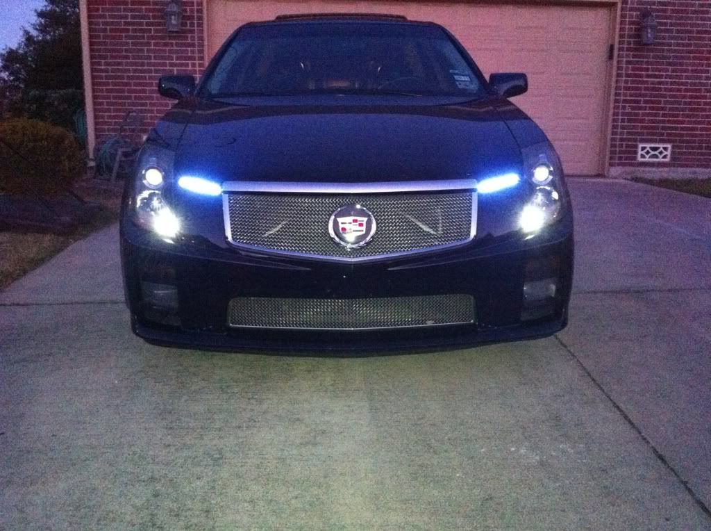

hey guys,
i tried to search DRL and all of that and i cant find this post anywhere
can somebody give me the type of LED strip they used for this off Ebay, there was a link on the OP
and can i also have how u wired it up? do you have it on a Toggle or just on w/ your parking lights?
thanks guys

haha thats my car. Get the lights from ebay seller: jaydencar08 he/she sells 4 x 12" strips for $18 shipped and gets to you in about 3-4 days. He might just sell 2 for cheaper but go ahead and get than one for spares. You have to cut the strip to length to fit it in that space and attach it via 3M double sided automotive molding tape. It comes with double sided tape already but use the tape I mentioned. I hooked it up straight to my orange bumper light and it comes ON/OFF automatically with your lights when its set on AUTO or manually when you use the light in manual mode.
I like it and its different. Good luck!!
