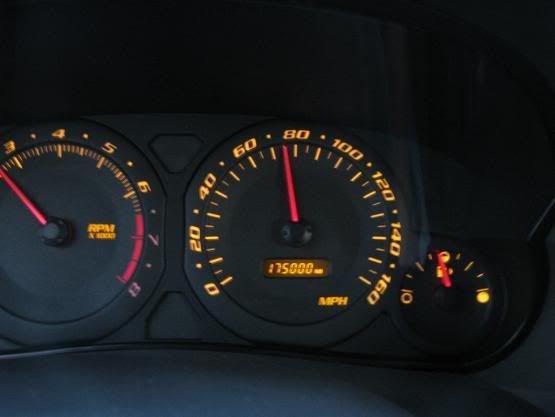

I was on my way out of town and I was ready to capture the moment. The canon was good-to-go. :) Still getting 27.5 - 29 highway mpgs.
Please excuse the focus.
As of this morning, the car has 175312. :)

wowww i was thinking 175 mph's. That would have been redic. But congrats on the 175 g mark. Im at 36,000 haha i got a little way to catch up to you.
'06 CTS
81 Posts
i was thinking 175mph too... although i must say, since i'm a recovering domestic car hater, the miles surprised me more than the speed.
