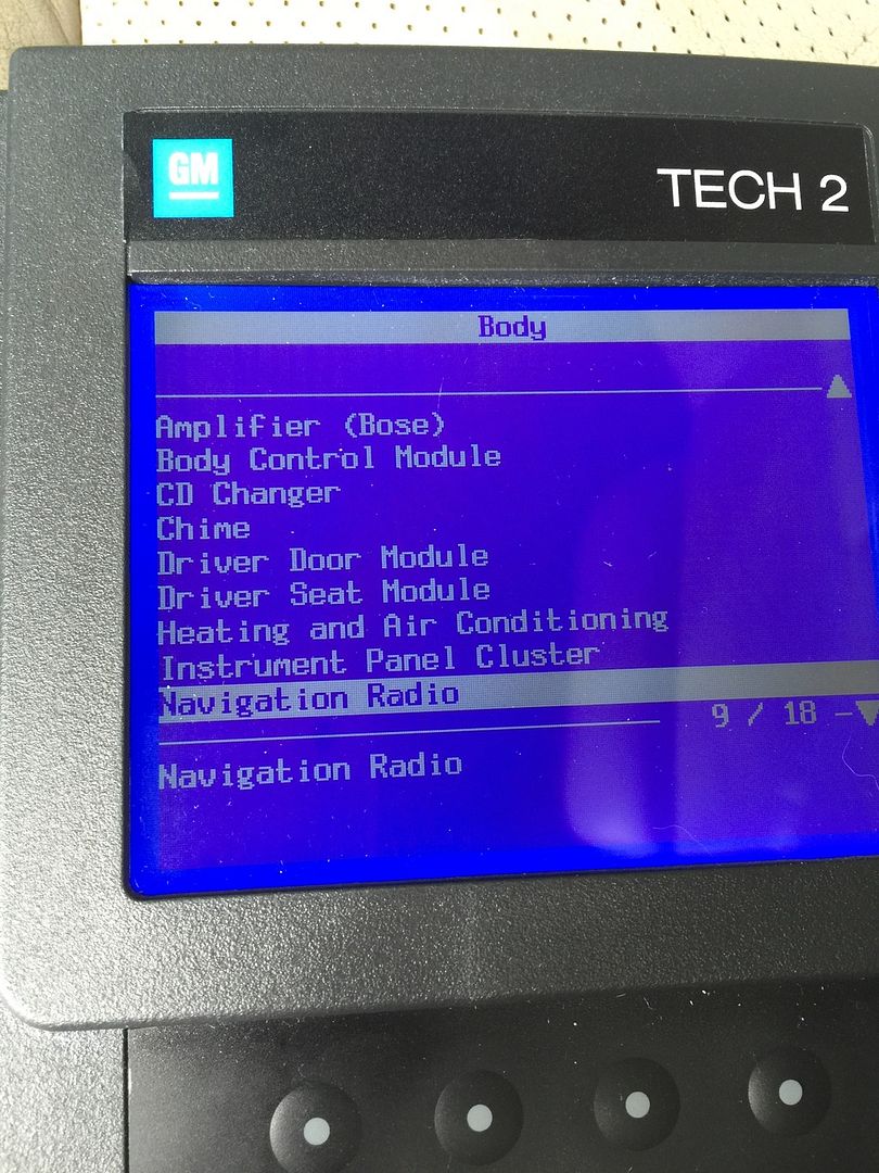

you will see another list under body(select radio or navigation radio depending on which radio you have installed)
then select the radio your wanting to do the relearn

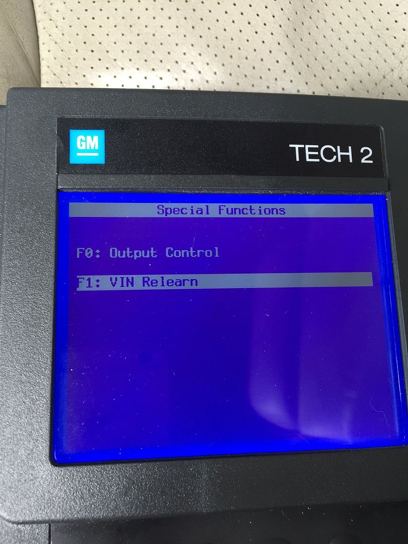

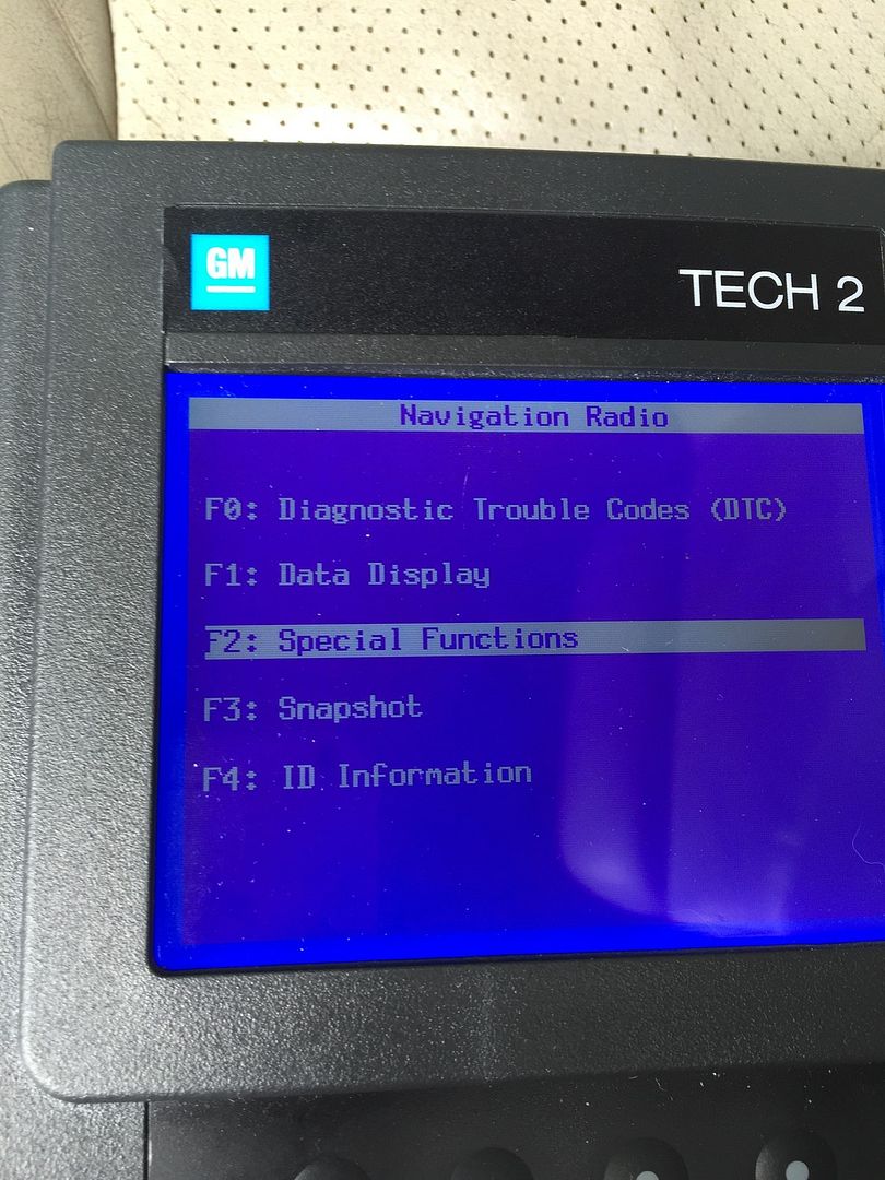

you will go into special functions from this list
select vin relearn(output control doesn't work well with our radios so don't mess with it)
you will then see this screen(tap the soft key below begin clearing to do the relearn)
[/URL
that's it your radio will now work
