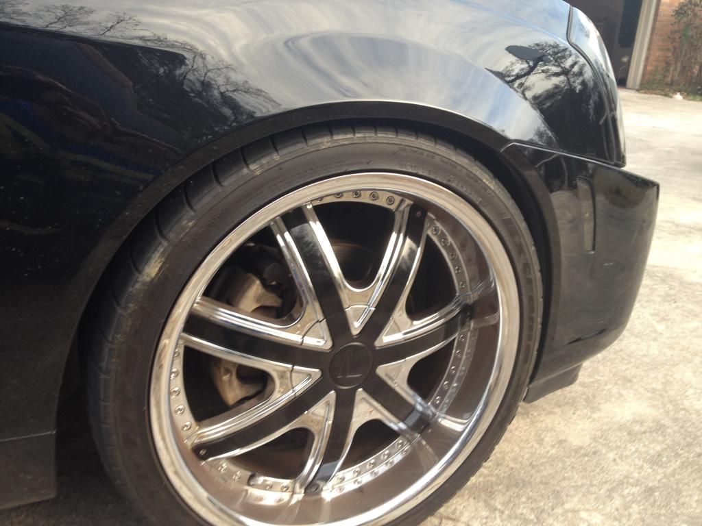

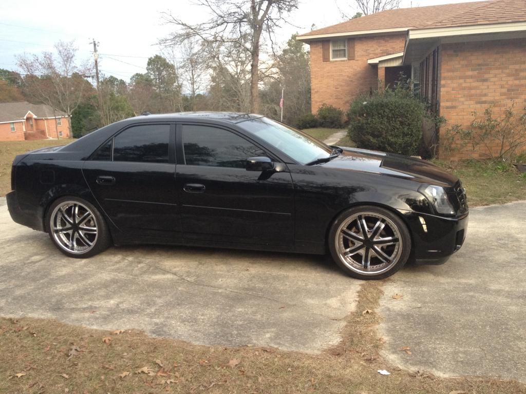

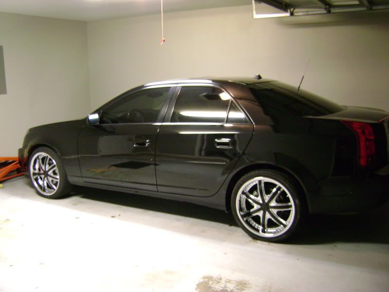

Wife got me the hotchkis springs and FE1 shocks for the rear since i have FE3. I guided her in the right direction. Here is a before pic taken when I first got the rims a couple of years ago and a few afters. Excuse the dirty car....If anyone is wondering about lowering with 20x8.5 +35 with 245/35/20 you will have to roll the hell out your fenders. Also take into account if you have FE3 and you switch to FE1 in the rear, that gave me another 1.5in drop or so on top of the 1in from the springs
Front
Rear

They are also trypically running +38 offset or higher. If your running +35 or lower with a 245 tire on at least an 8.5 in rim you will have to roll if you lower it
