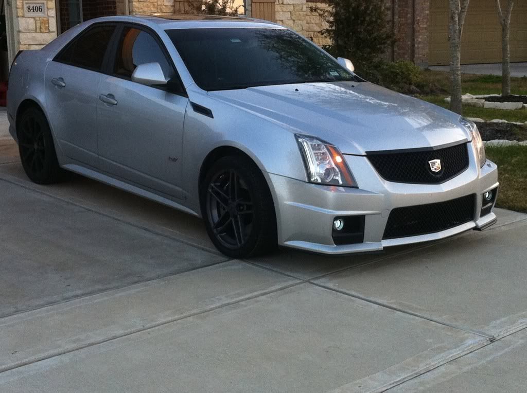

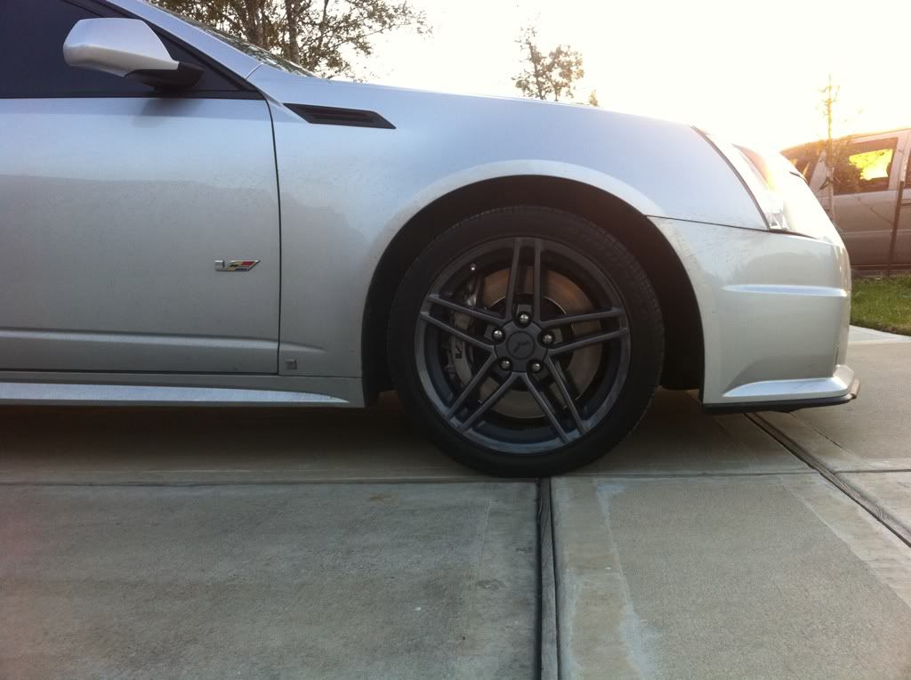

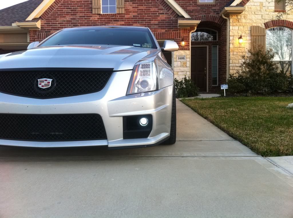

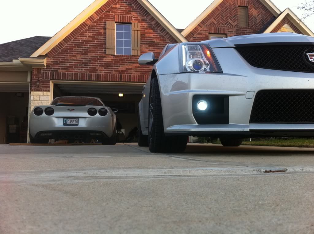

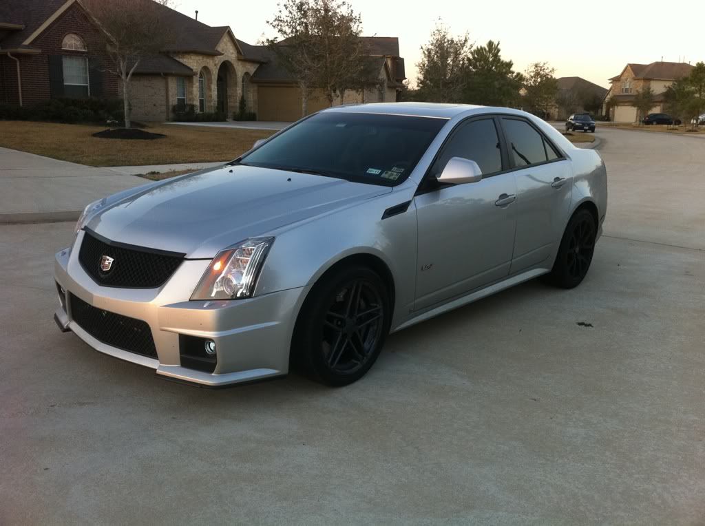

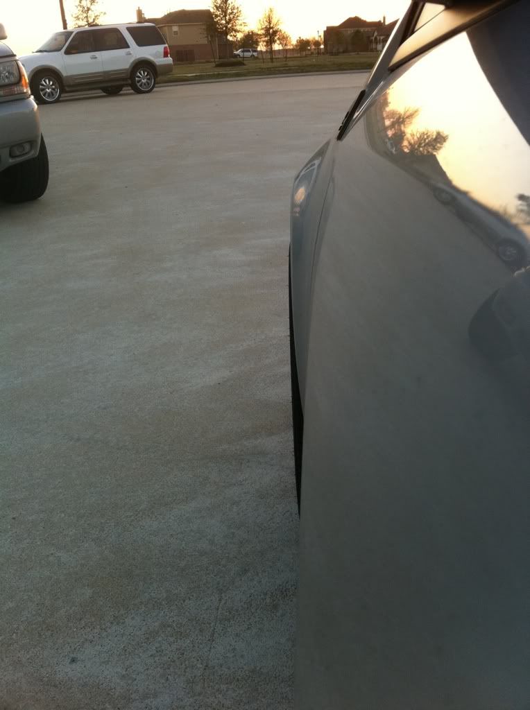

well I know I have said I was going to report back to you all, but time just couldn't be found. Well since my v is up on blocks again to get a rim fixed thanks to the Dippy dealer here you have it. 275/35/18 2007 C6 Z06 rims on a 2009 CTS-V.
No rubbage, no issues what so ever. Drove around the block, did figure 8's at full lock and no rubbage. So.... if you guys want to, there is another option. I know the one picture looks like it sticks out past the fender but it's really not. I tried to get a good angle but it just wouldn't fit. I will note though, if you have a crappy tire balance you will probably rub the weights on the caliper.
I do like the "wide" stance look....
there you have it gents.... Don't give me crap about my rims or car, I know they are dirty, but it rained the night before I put her up on blocks, and I just got the z back from putting cats on her so she is dirty too.... sorry...

I'll tell you now no way the 305's fit on the front. When I tested for rubbers they barely clear the back arm that comes down from the top (sorry not sure what it's called) the calipers clear with about a .3 in clearance so plenty of room. Only issue would be if the sticky weights were not located directly up against the edge...
