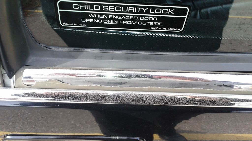

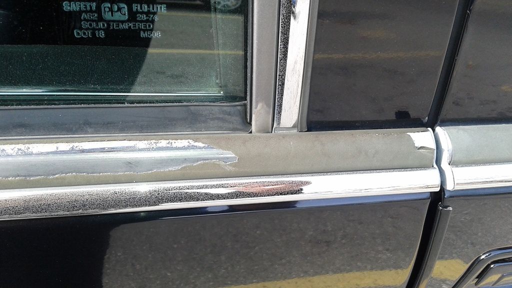

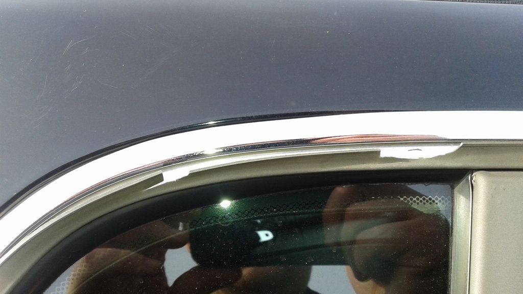

My mother pointed out that some of the trim around the windows and on the door was flaking off so she decided to peel some of it off now it looks pretty ugly with some of the trim remaining.... We've had some rain lately and water doesn't appear to be penetrating anything, is it safe to remove this trim? I actually like the chrome underneath it anyway!
1995 Fleetwood 1968 coupe DeVille
1,152 Posts
you can take the stuff off, it wont hurt anything...there are no aftermarket replacements...all of them eventually dry rot and flake and peal like that...you can see the rubber on the outter edge also shrinking and coming loose...
I didnt do around the windows yet, just the belt moldings, ill give you the easiest way ive found. and im telling you this because some of it will peal easy and some is really on there...I tried everything from a razor, scraper, sandpaper, chemicals ect
a 3m earaser wheel for removing pinstripes and double sided tape from vehicles takes it off with ease and you can do it on the car as the wheel wont hurt anything

Thank you so much for the tip I will be removing the rest of the trim as soon as I get the earaser!
