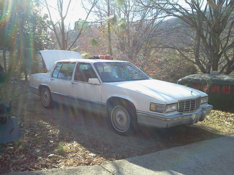

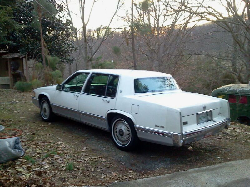

I know I need new rear shocks (one is leaking oil), but I don't think the hydraulics has anything to do with the ELC? My car sags down in the back now a little even without a load (see pics below) and the suspension bottoms out often? It doesnt look that low however, but once driving and accelerating the rear sinks.

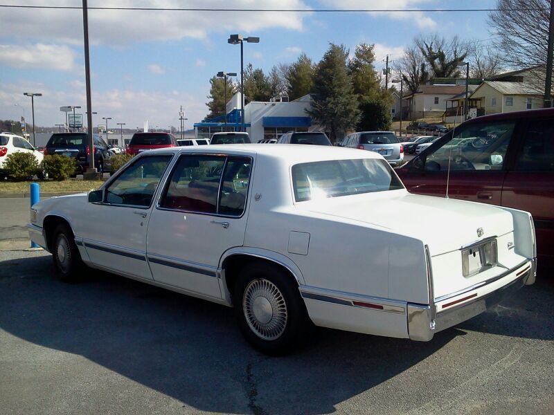

Here it is setting at a local Cadillac/Chevrolet dealer parking lot on the level... (note the 92 deVille in the background at a used lot, lol).
... and I walked on over to see how that one was setting and it looks about the same...

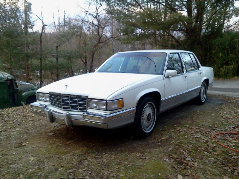

and I took this one yesterday...

Honestly that rear ride height looks okay from the pics. Mine is pretty much the same unless I have the car loaded completely with people and other stuff. (My elc is disabled and I have all round KYB)
When you say bottoms out, what do you mean? Are you scraping on the road??
