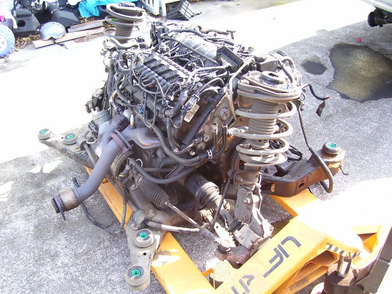

I put the cradle on a pallet jack (which was actually the perfect size!) and rolled it out through the wheel well. The only problem this posed to me was when my dad told me to change the oil pan gasket too since the engine was out. I had a hard time getting to the bracket going between the oil pan and the tranny (to remove the engine and suspend it with the cherry picker). I managed to do it though.
Now THAT is the way to do it if you have access to a pallet jack.

As you can see, out the side is the way to go. The wheel wells give you clearance so you don't have to raise the body as high.
