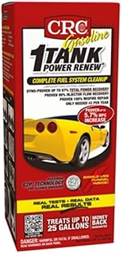

I'd change the 30 dollar valve myself - easy peasy, buy some throttle body cleaner ( not carb cleaner) its a easy cleaning when you remove it completely, buy some CRC cleaner
