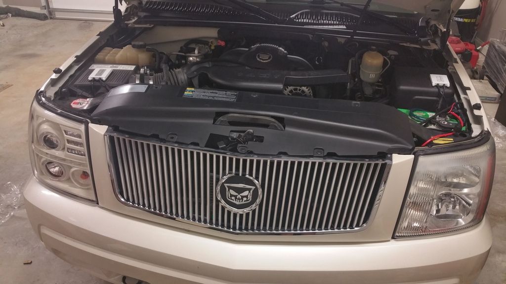

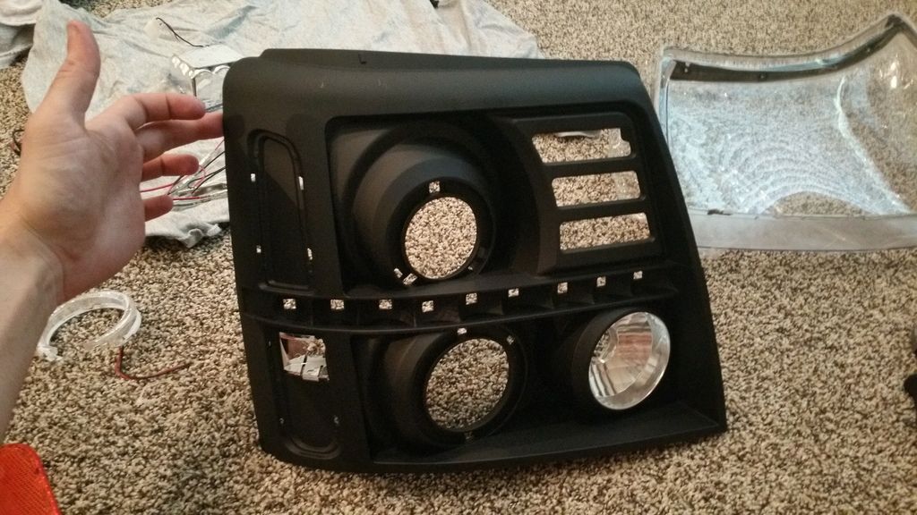

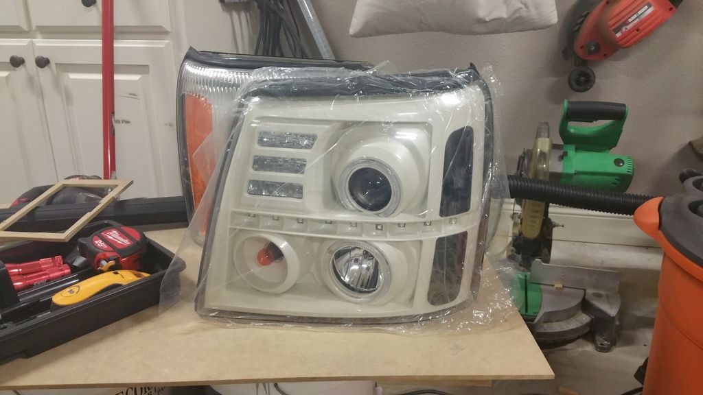

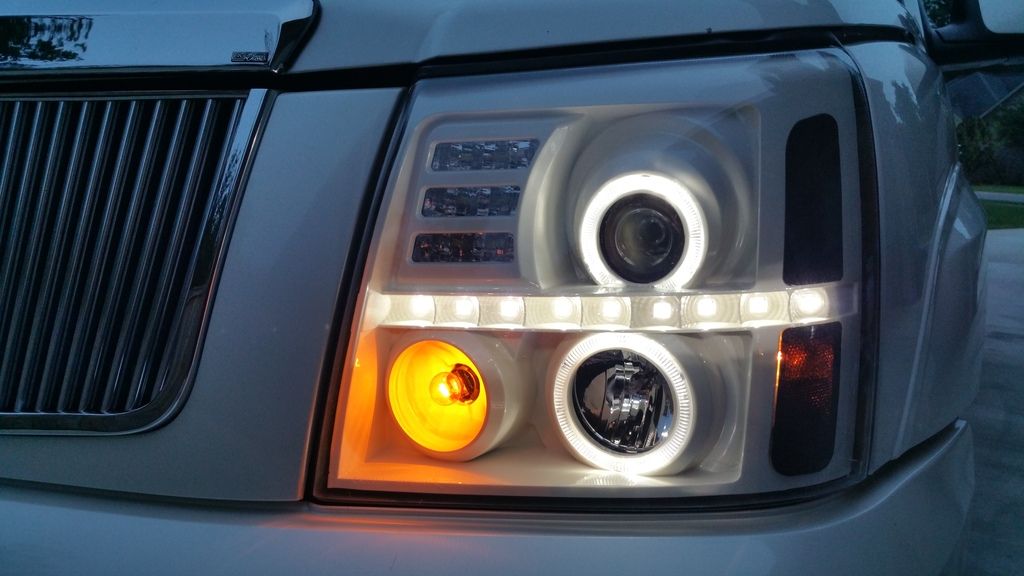

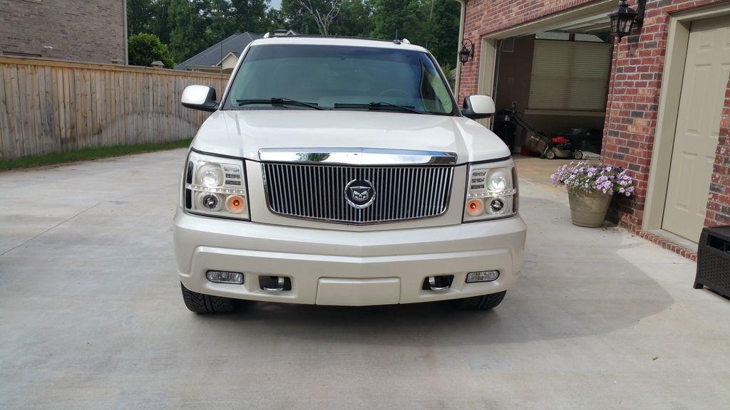

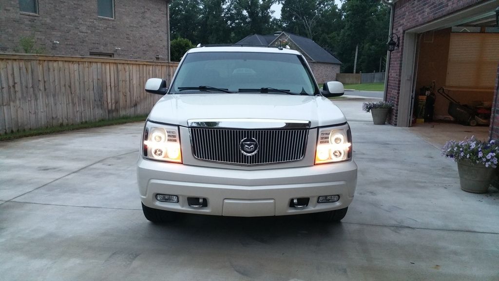

My headlights were fogged on my 02 EXT i just purchased used, so i went ahead and swapped them out. I took apart the headlights and had the black interior piece painted diamond white to match the truck. i think they look awesome and now I have projectors for my HIDs :) Just thought i'd share some pics. let me know if you have any questions.
Captain
started sealed up looking like this:
completed and reassembled:
on the truck:
completed:

Wow they look great
I think I may get black to match my truck when I do get new housings(which will be projector style)
I have to say they do improve the beam of the hids big time and make the truck look a lot better
