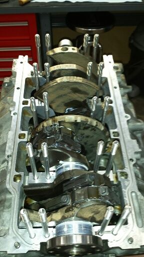

I would not attempt to drill and tap 20 main bearing holes with the crankshaft still in place. 10 of them on one side go thru the oil supply passage to the crankshaft and they would need to be surgically cleaned after all this drilling and tapping to avoid anything getting flushed into the crankshaft oil supply.
Below is a photo of the bottom end my 2001 Deville engine rebuild. I had replaced my main bearing bolts with studs from NSP but note the very little clearance between the inner most bolt hole and the crankshaft bearing journal.
