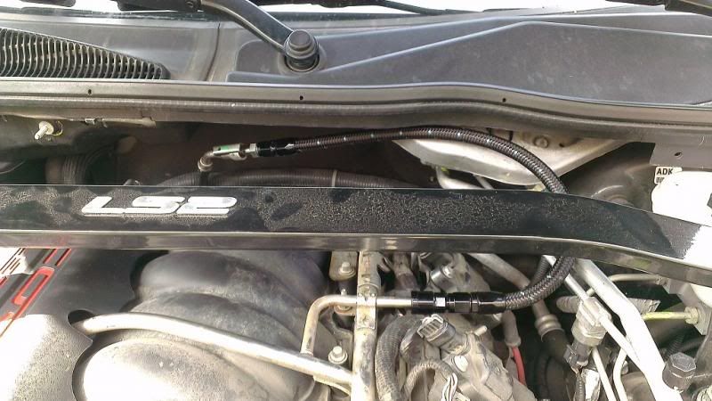

Recently upgraded my fittings to -10 but kept the hose size at -8, this way i am getting full flow of fuel through the rails...
Doing the same thing on my Maggie for my Tahoe with a 403ci...
With everything stock, are these -6's restricting fuel flow??
Also, I'm wondering if there's a 90 fitting for this if it will still work with the fuel rail covers... Looks great with a 90 but with my previous pictures, it looks like it may be too short.
Maybe this fitting...
Here's mine:
G
-6AN is 3/8" ID, same as the stock fuel line.
It looks like it might be close with a 90 deg fitting. It may take just a slight modification to the cover for it to fit perfectly.
