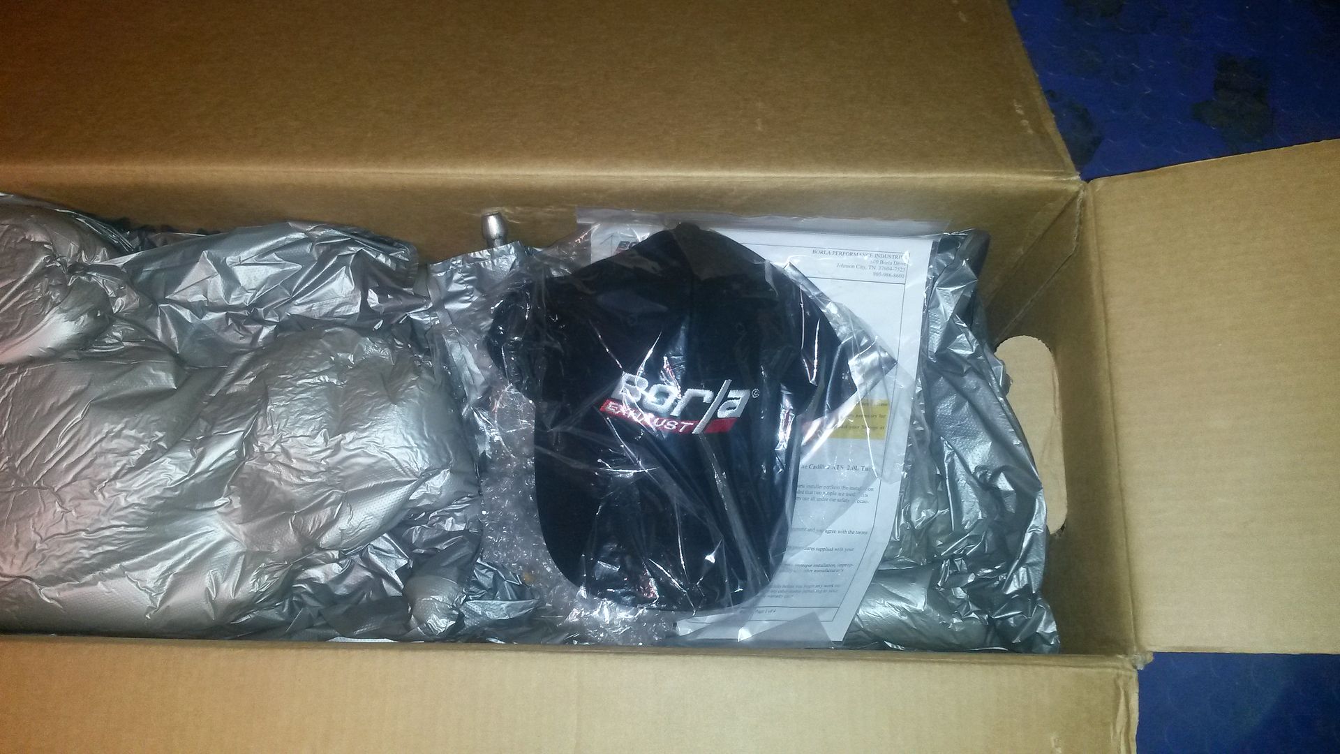

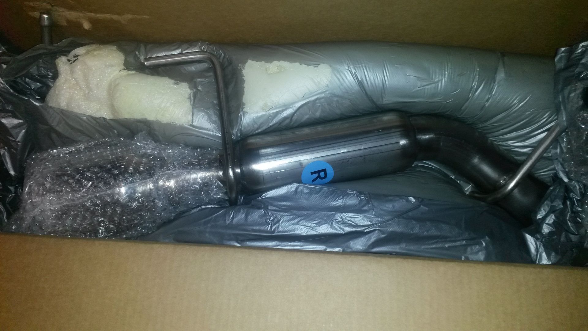

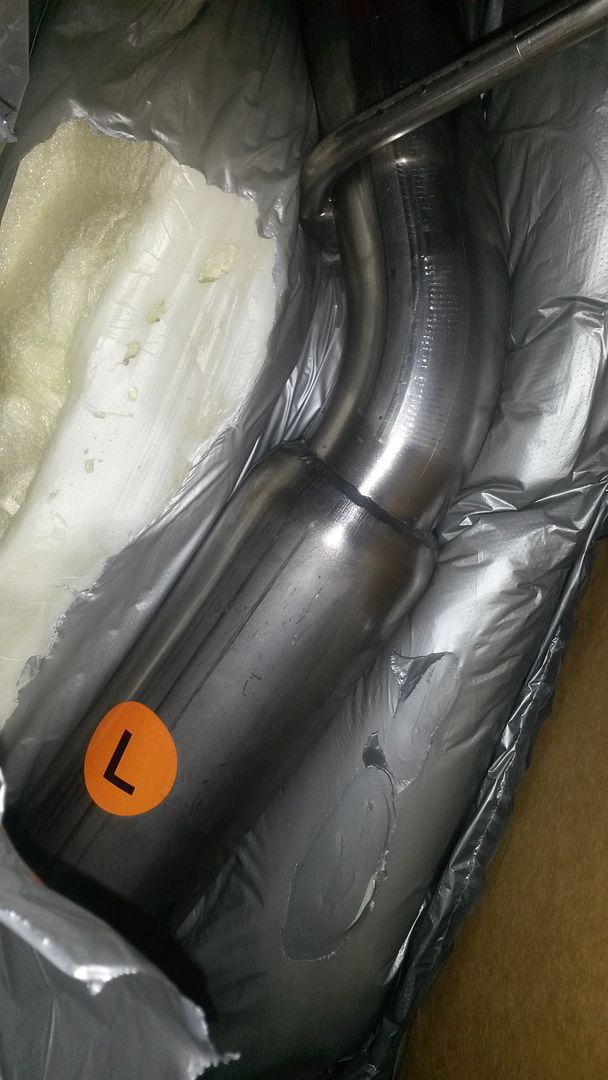

Got notice from UPS - it was delivered this afternoon, and will be installed tomorrow morning.

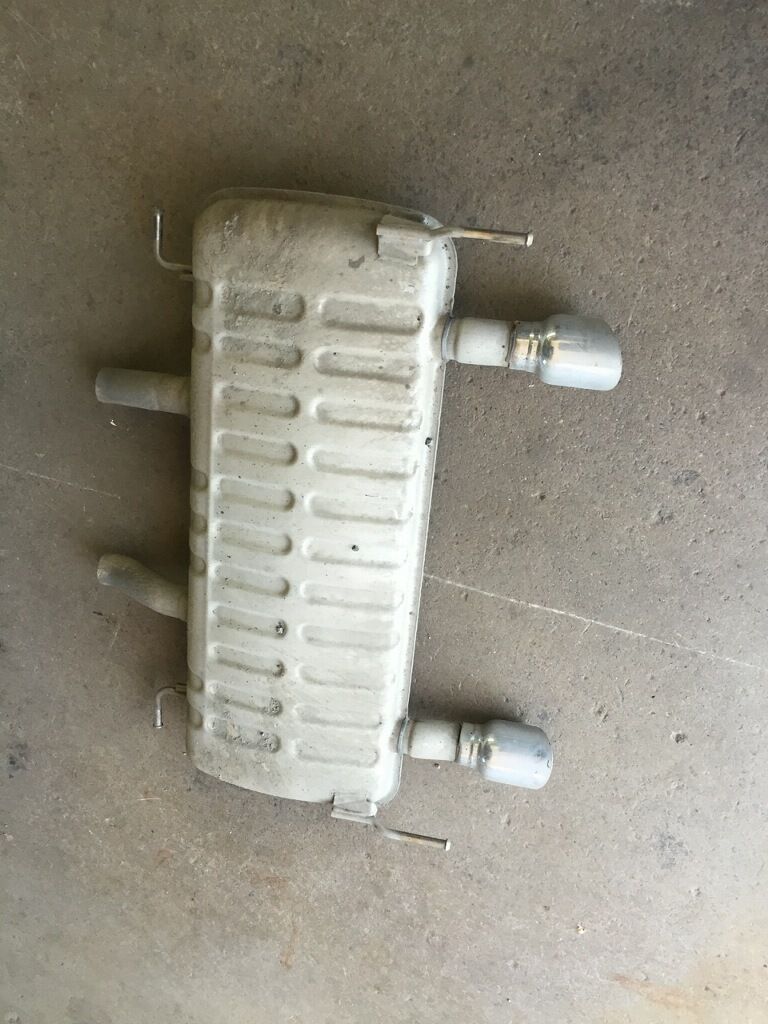

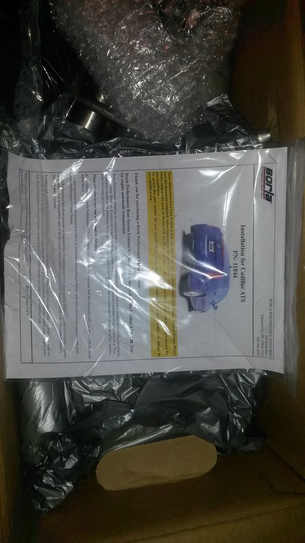

Pic of the stock suitcase muffler - we did not have a scale handy, but my buddy who owns the shop and I both guesstimated the weight at 20-25 pounds.

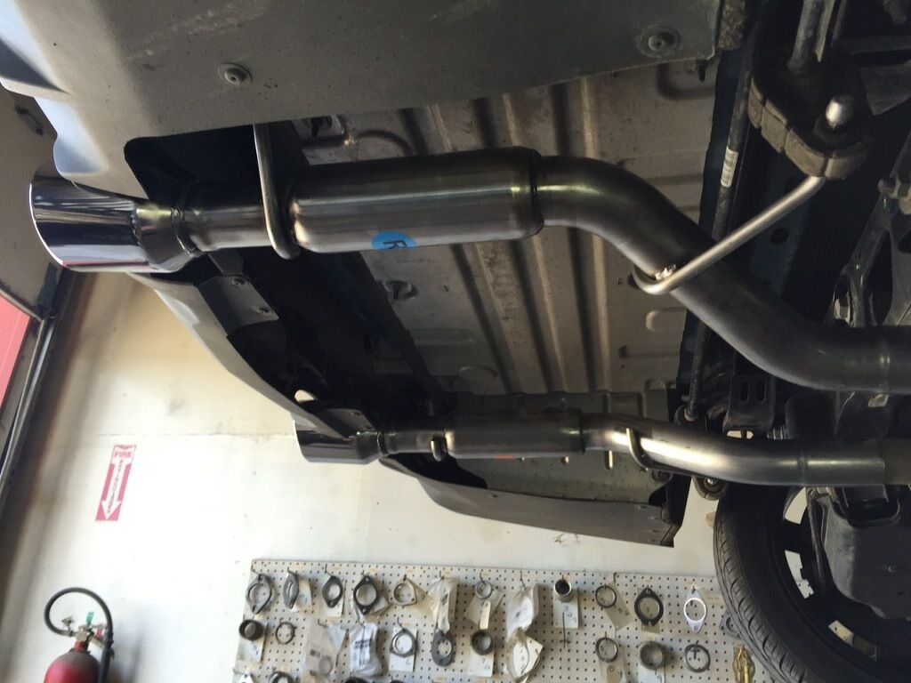

Test fitted

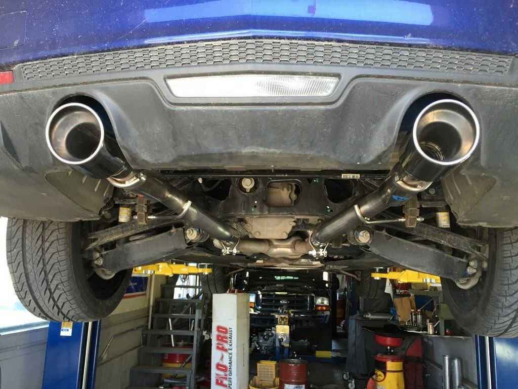

Prior to final installation - they weighed about 5 pounds each, so all in all you will lose 15 pounds or so.
The only nit to pick is the clamps - they look great but even torqued all the way down, the pipes could still twist and be pulled out. We elected to weld them in permanently.
