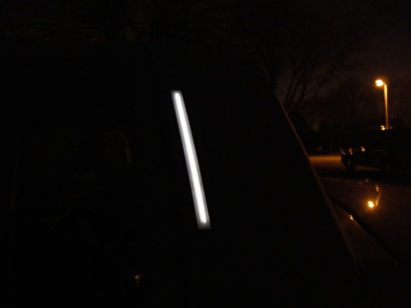

On the other hand, LEDs produce a rather harsh and bright light. They can be dimmed but it is unlikly that you will get as even of a light pattern as what you get with the paper. Here are pictures of both my '88 and my '90. Unfortunately the inverter on my '88 took a dump at the end of last year so if anybody can get me a working one I would pay you handsomely.
