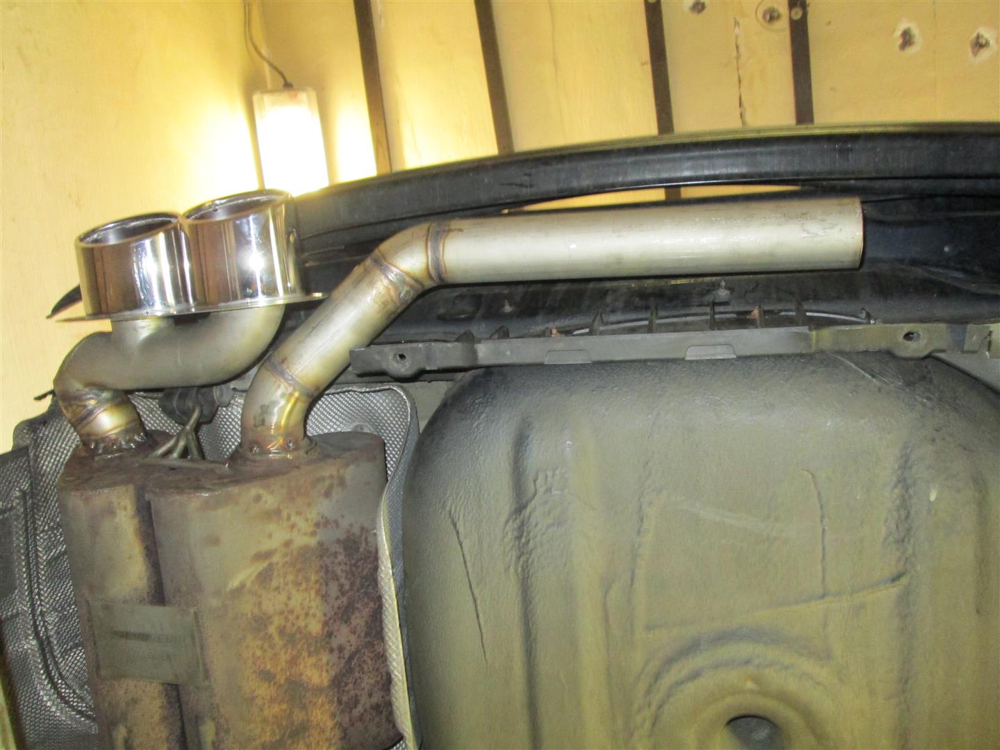

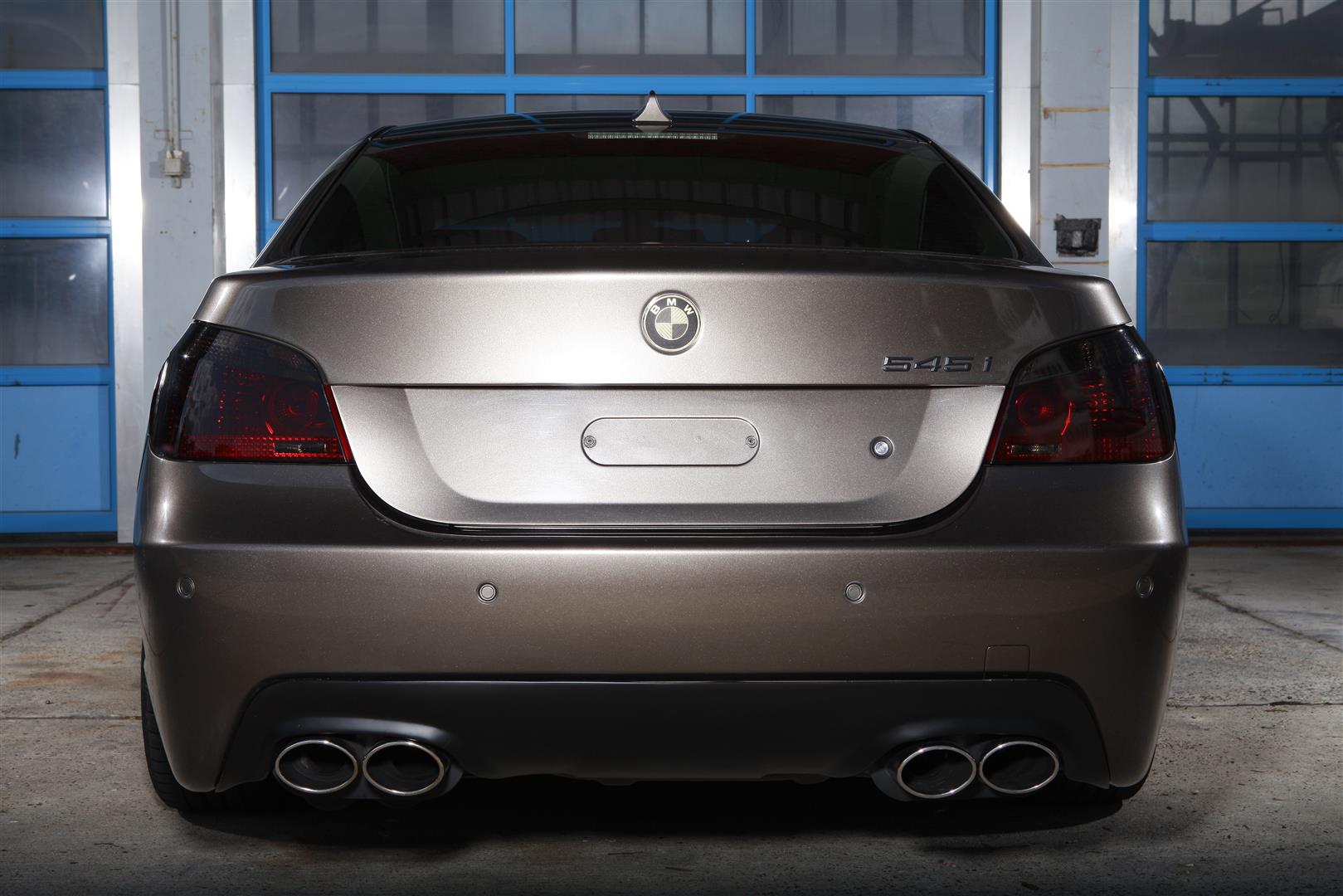

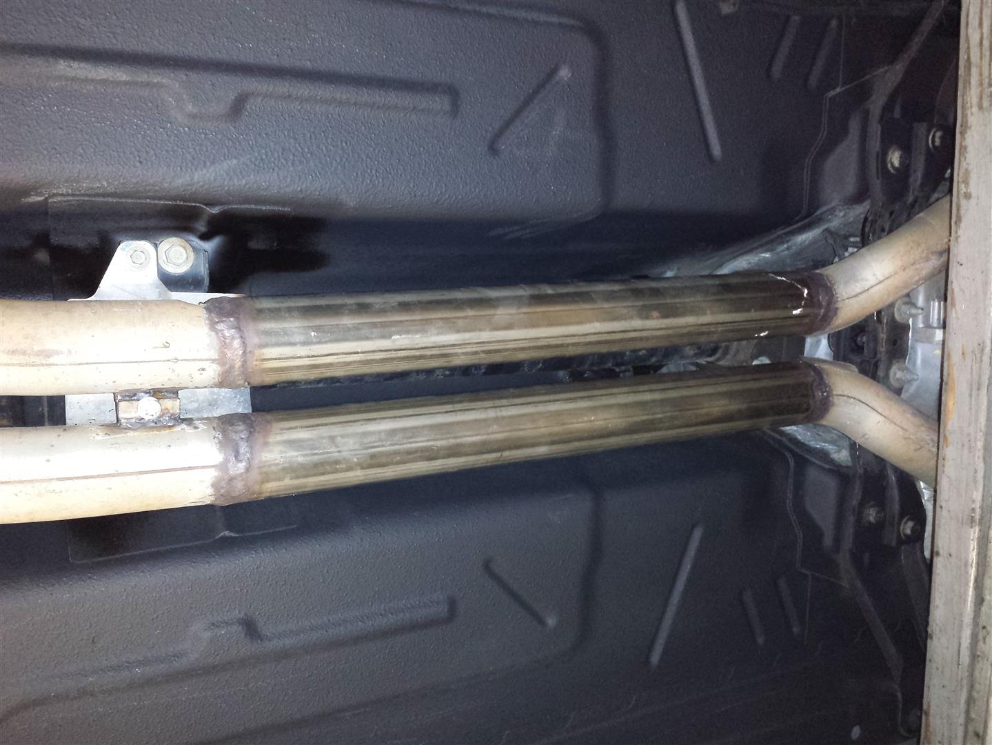

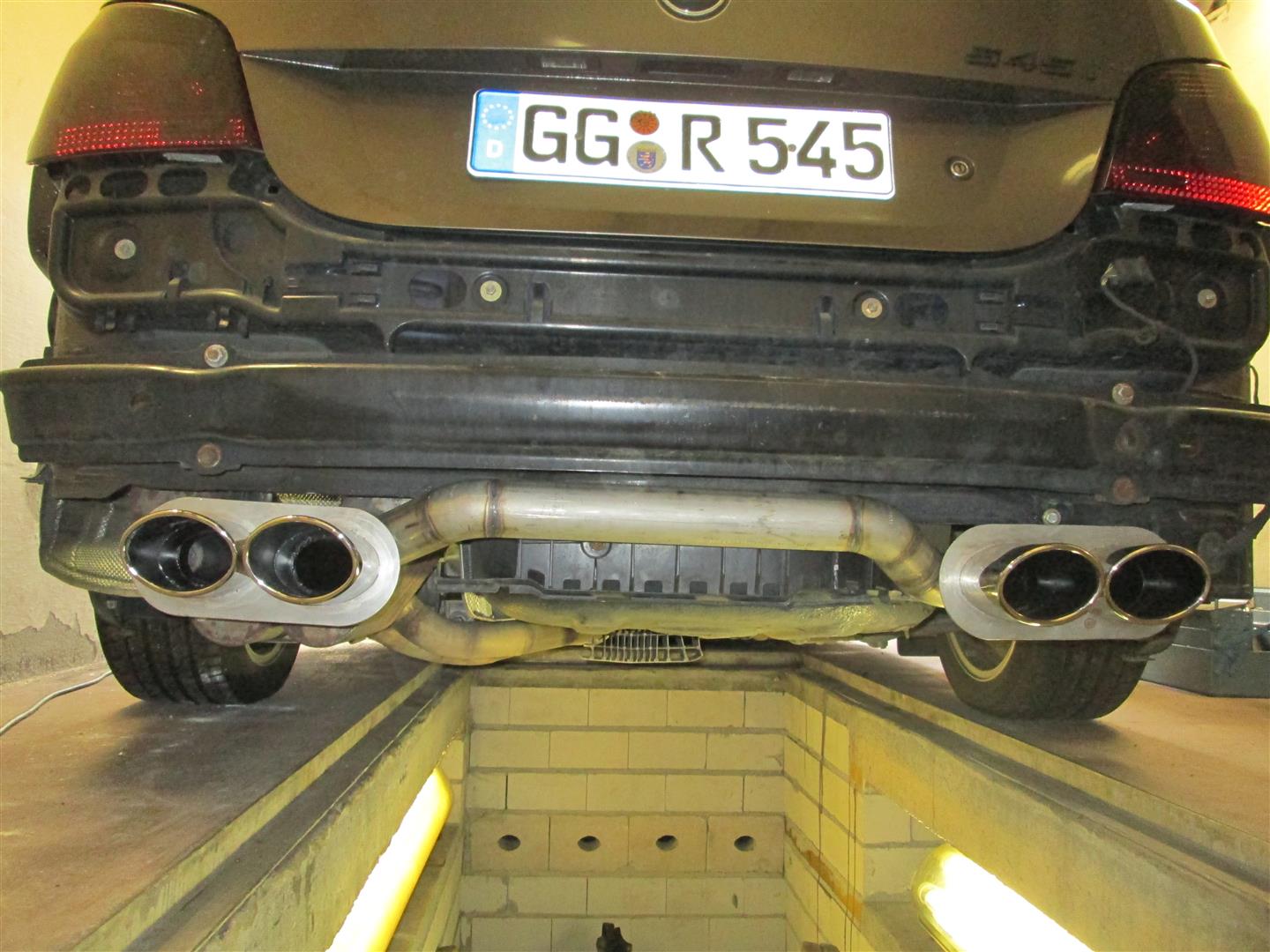

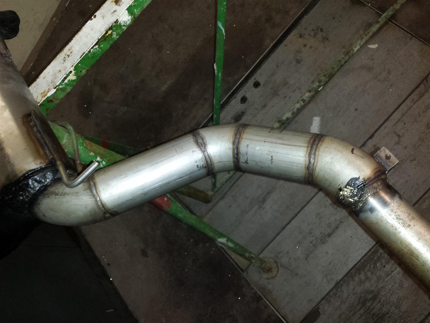

Benchmark is my old BWM 545i which has also a selfmade ex-System with 2x Flowmaster Super 44 in the rear and 2x HP2 in the front, pics are here:

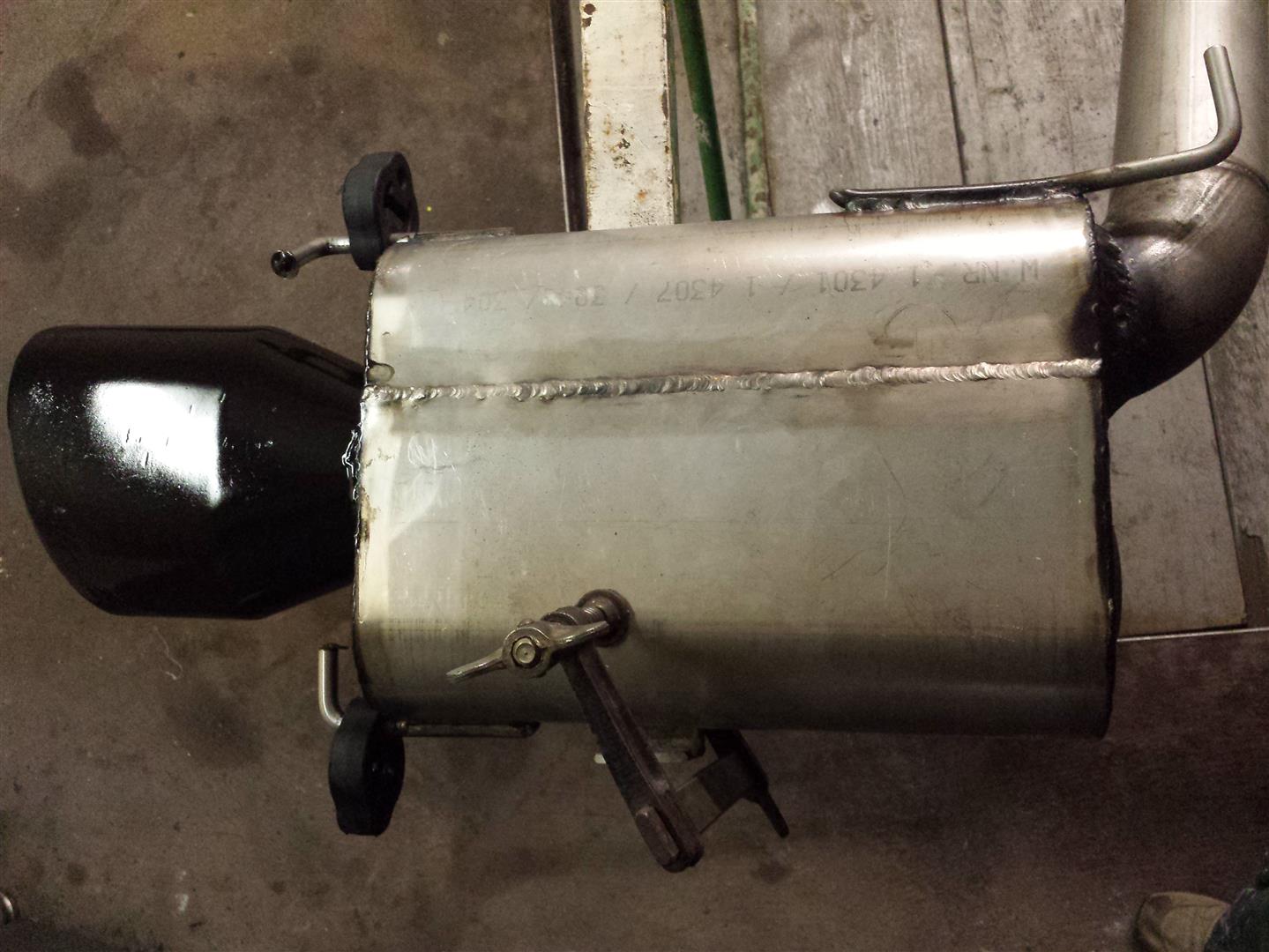

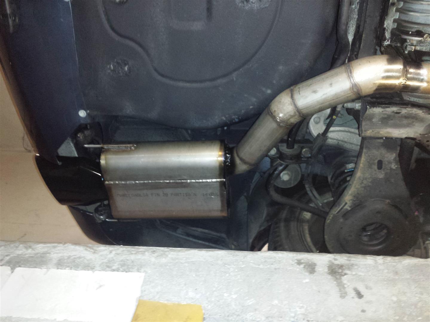

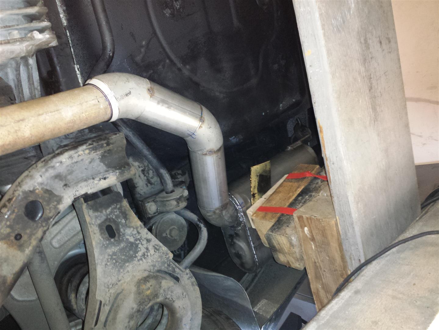

And here are the new once, still under my car:

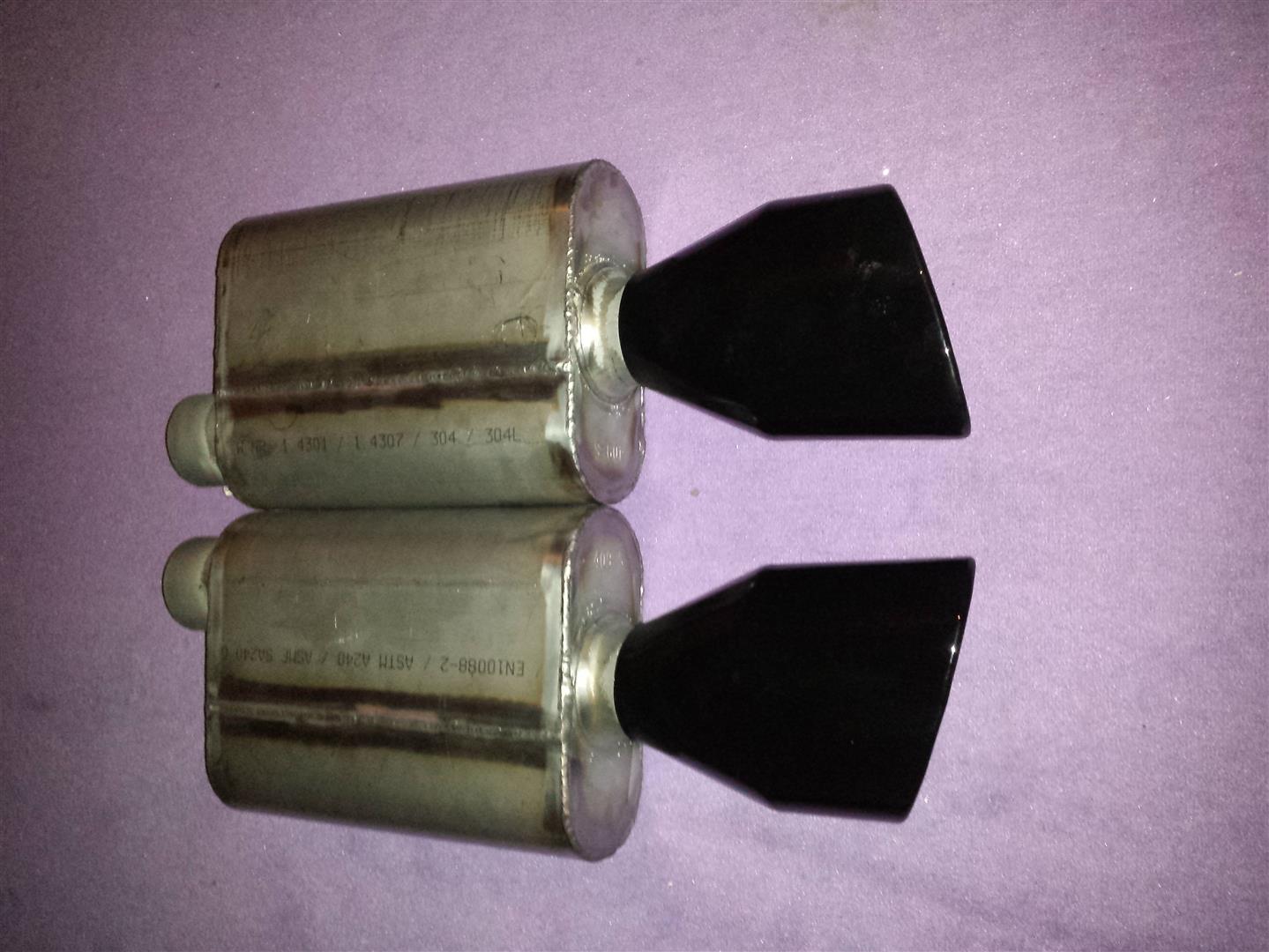

Installed are 2x 3" Flowmaster origin 40 Series with special plated case in truly rustless 304 stainless steel not that crappy 409S which looks like standard steel after 2 season in winter with snow and salt (look at the pics above on 545i !) and Resonator delete, no X- or H-pipe, tips are 160x95mm Audi RS6 style shiny black sprayed!
Now i have much drone inside the cabin between 1200-2000, which surprise, i know... :-(
Thinking of installing a drone-cone like the vortex, in the HP2 on BMW there are some double cones inside and i get not only one drone inside, but he is better isolated then the Caddi, that helps also a lot i think, someone have experiences to get rid of that f**ing drone tone?
